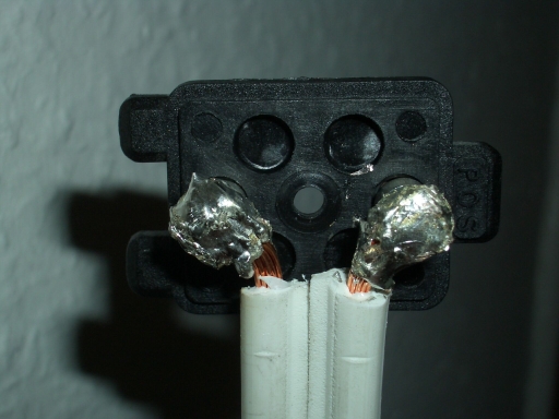

Most definitely not! Looks as if you could almost pull the wire right off the plugs on some of those!

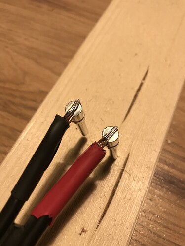

Might as well ask, are these ok? Just did them myself
Changed from these
Have now listened for a short while. Seems to sound a bit different. More composed and with less harshness.

They look great. A nice job.

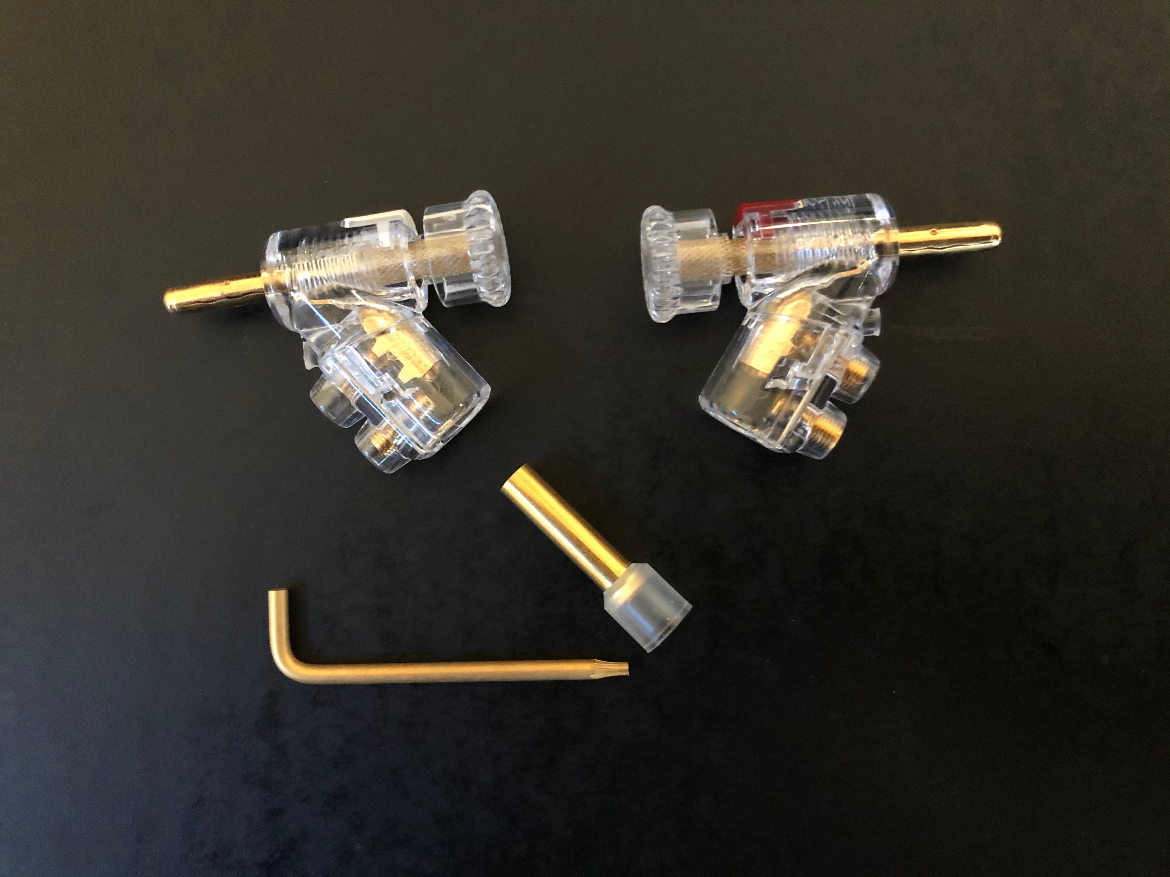

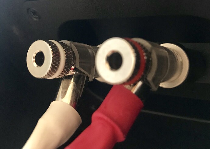

At the speaker end the cable is terminaler with wbt 0610 nextgen.

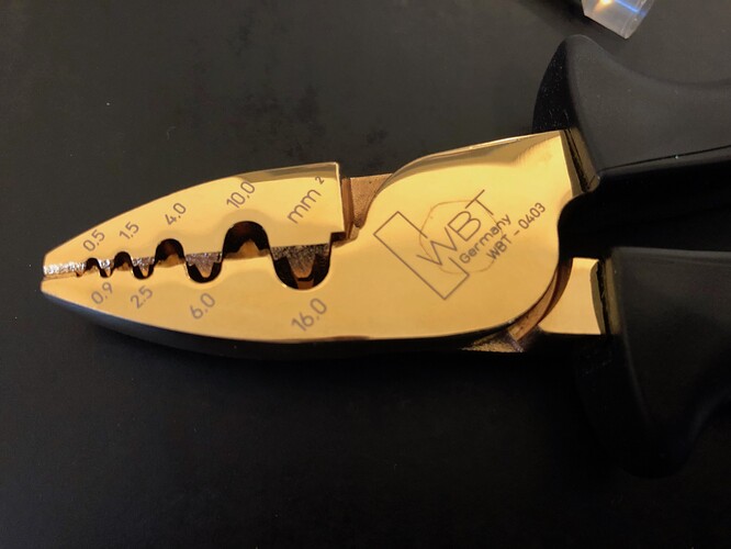

If it was me I’d find a dealer who has experience terminating with WBT plugs and crimp sleeves. One needs the WBT Crimping tool, and the correct sized crimp sleeves. But IMO it’s is the best. NexGen !
The Crimping Tool was a Xmas Present to myself.. a Bit Pricey
Those are the ones I have at the speaker end.

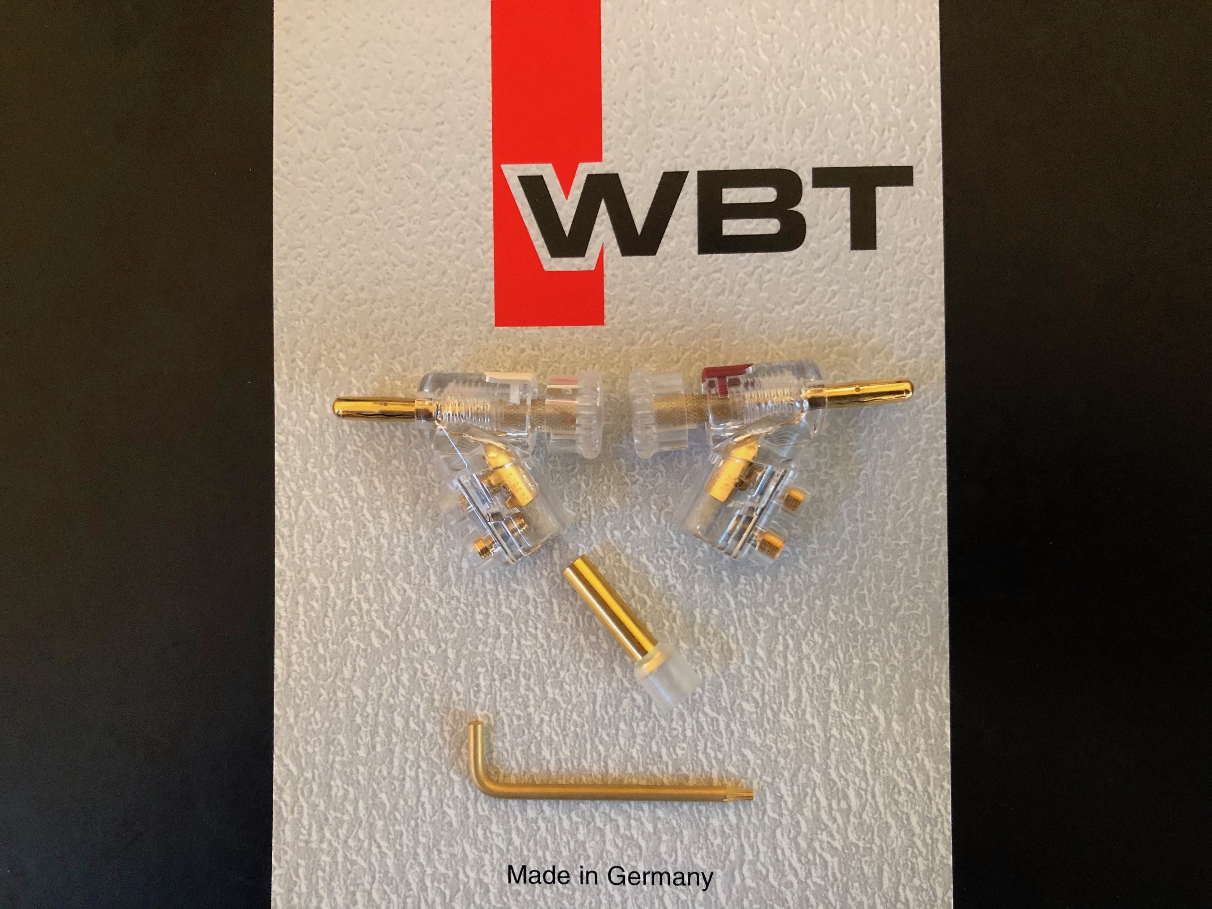

Edit: sorry, I looked and it’s actually these
WBT FP 202 Rhodium
No solder or crimp but a screw that connected the cable.

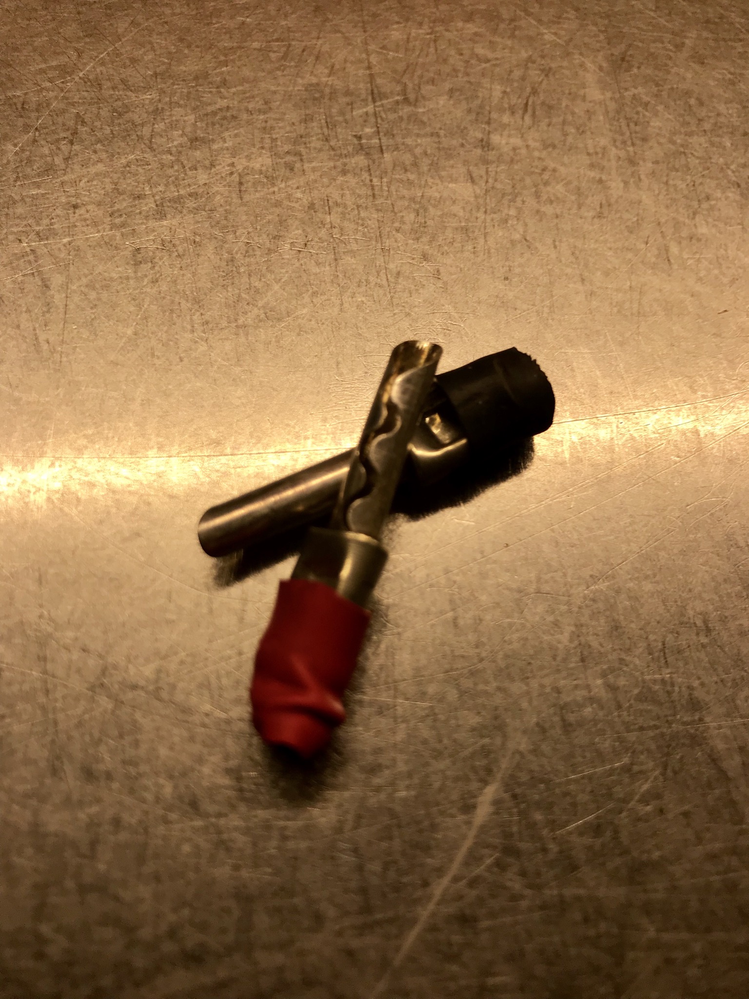

Aaaaah! Just ruined those trying to solder them. Couldn’t get the heat upp with my tiny iron. So mad! I had excellent sounding cables. Now they don’t even work since the bananas are ruined and one didn’t even stick. No cables, no musicđŸ˜©
