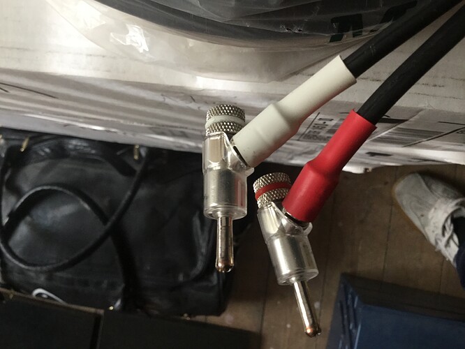

To fit these properly there should be a crimped sleeve over the cable which is then inserted into the plug and secured by the screw.
I see. Crimped sleeve missing. Got to get new bananas now. Any suggestions?
Why not just reterminate the WBT plugs. Check out their website for details on what you need and how to do it. :+1:

Because I now ruined them with solder in the plug and through the tiny holes where the screws that clamp the crimped cables are.
Oh dear! We live and learn.:+1:
Can you post pictures? I’m not sure why you’d try to solder on a plug not made for it. Also FP 202 are Not WBT’s they are Furutech…And Rhodium is super hard and very hard to solder. If you can remove the cable from the plugs and remove the plugs from the amp. You should be able to heat up the plugs enough to shake the solder off. I’m guessing it’s a Naim amp?
Oh and from the original picture it looks like the cable was terminated with a Rhodium crimp sleeve. So get it all cleaned up the solder most likely didn’t stick if you mangled the little screws if you have any kind of small suction device, like a syringe or a little mucus sucker like you’d use on a child. You can heat up the solder and suck it out of the screws to free them up.
Have you tried a solder pump or wick to remove the excess?
Im not sure he knows what that is. I think he may be able to just knock the solder off since the Rhodium plate is very hard and solder really won’t stick to it.
I feel bad for you Lucifer, What even gave you the idea to solder these plugs?
The crimp sleeve isn’t missing its either still in the plug or on the floor or something.
I did and got rid of most of the solder and you are right they are Furutech, my misstake. At least one of the screws are now back in place on each of the plugs. Two of them only has the inner screw reasembled. The outer one doesn´t get in. Perhaps still solder in the screw hole. I used a solder pump to remove the solder.
Now listening with the bare wires at speaker end and Naim plugs at amp end. I´ll put the furutech back shortly (no solder😁)
I think these plugs, which I thought were WBT, but are Furutech possibly never had sleeves. IR are you saying these should have sleeves?
If they are the Furutech Rodium plugs that I had with single or twin Allen key screws, then there was no sleeve. The screws are what secured the cable in the plug.
They are Rodium with twin Allen screw
I will see if I can add picture of them.
The twin Allen screws are underneath the coloured heat shrink, for ease of channel identification.
Just like mine
