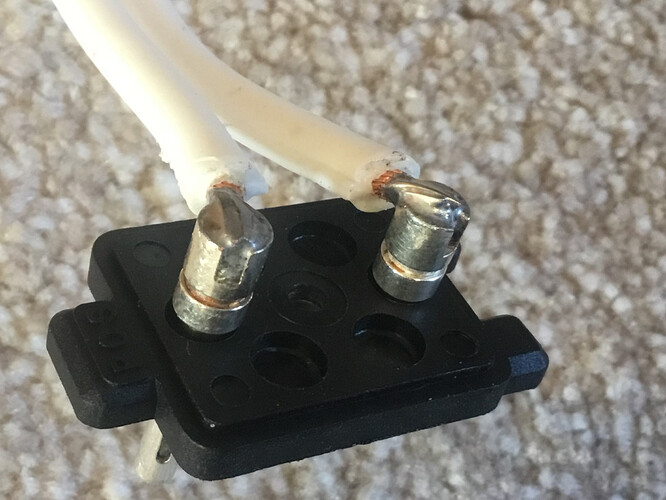

Not the worst I’ve ever seen, but not the best either. I would agree with Stephen’s comments. Also, the wire and solder should not protrude above the top of the pins, so that you can screw the cap on properly and not have it clamping the pins in place.
Thanks Stephen - that’s useful feedback.
The system does sound great at the moment - but I’ll take your word for it that it might sound even better if this soldering was even better.
I’ll put it on the hifi jobs list.
cheers
Jim
Yes, this is really important and so often overlooked. The pins should be free to move slightly within the plastic housing - this allows them to be supported yet also able to follow the best contact path down the 4mm socket.
Given the obvious specifics required with these soldered connectors, I’m curious why Naim themselves don’t offer a NAC termination service or ability to order pre terminated sets at specific lengths?
Maybe it’s just my dealers level of enthusiasm or perhaps confidence but he’s never mandated a soldered connection or in fact recommended it even, which seems to go entirely against what everyone says on here!
I have a certain level of trust and respect for their abilities and willingness to support me as a customer but it seems entirely open to interpretation and based on personal preferences alone.

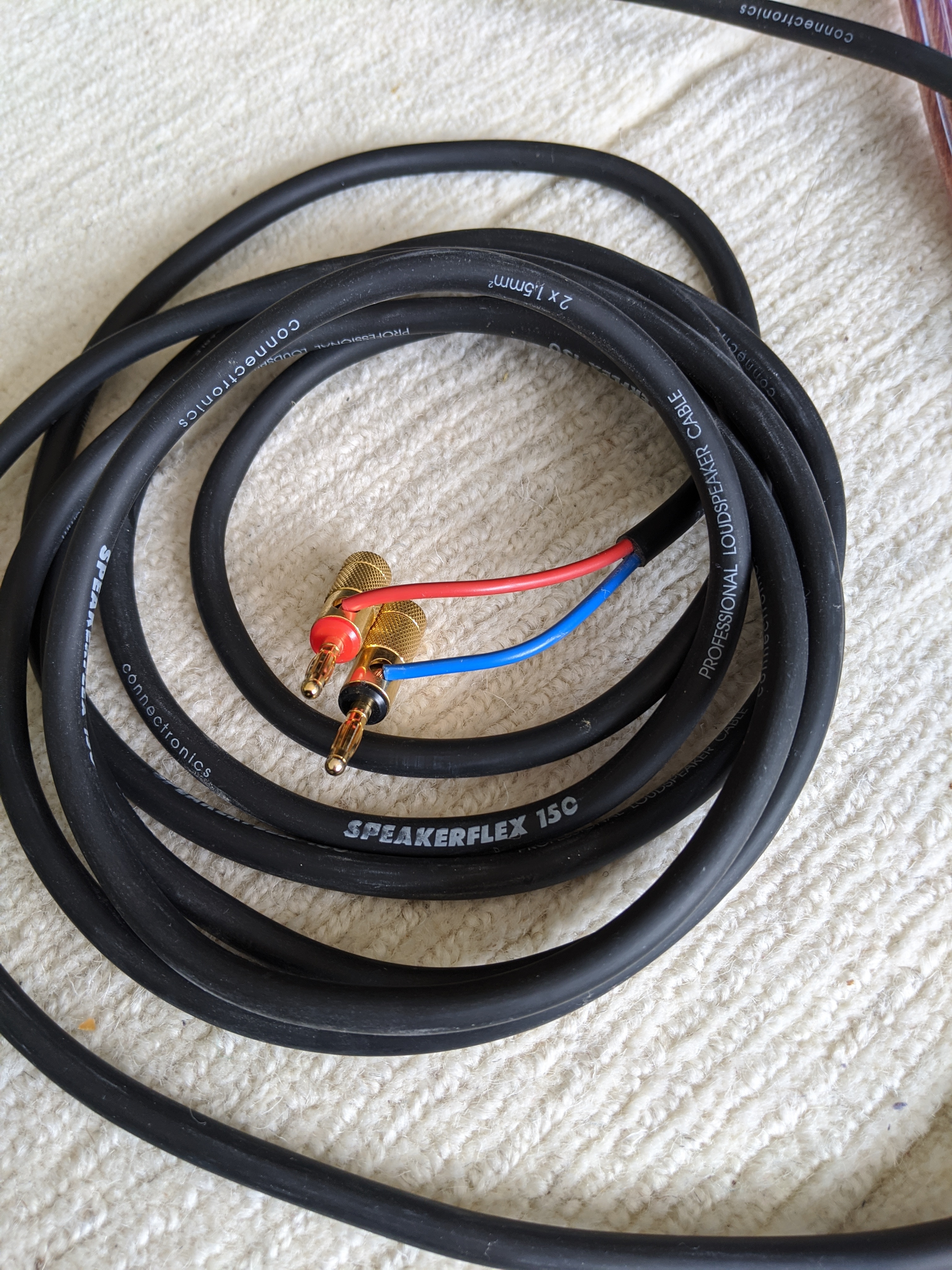

Just received these.

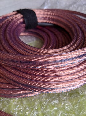

Van damme HiFi 4mm and some jumpers too.
Replacing some old Speakerflex which I’d had for many years.
First impressions are good with more detail and lower frequencies.

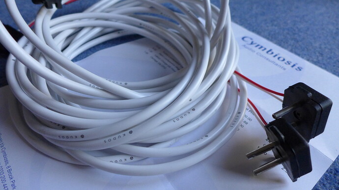

That previous shot was an amp end of a NACA5.
Here’s a speaker end photo.
This one looks better, and I think there is a wee bit of wriggle room for the pins within the plastic casing.
But I don’t know what type of solder it is - and clearly there’s a little bit of copper wire showing.
Is it just me (most likely) or does the Nac5 , and that Van Dam wire all look like either old style Monster Cable or big Lamp Cord?
No, it’s not just you ![]()
