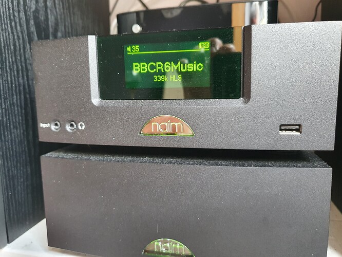

The Radio 6 HD channel sounds a bit weird, but is surely great quality?
Does anyone know what quality this is? I am a bit flummoxed tbh!
Sounds really compressed and lacking any emotion, whereas Naim, Linn Jazz etc v acceptable sound, much smoother. I prefer Spotify HQ overall, even after giving Tidal Masters a whirl.
yes BBC6Music HD is 320kbps fixed AAC using 48kHz sample rate.
It is similar to Apple iTunes downloads or Apple Music streaming other than with a slightly higher sample rate
The reference of HLS on the display is misleading unfortunately - as that is simply an adaptive streaming carrier protocol that can carry several possible codecs - the media used by the BBC is actually AAC carried by the HLS
Ok thanks, for some reason I expected it to be Auntie Beebs finest, alas not!
