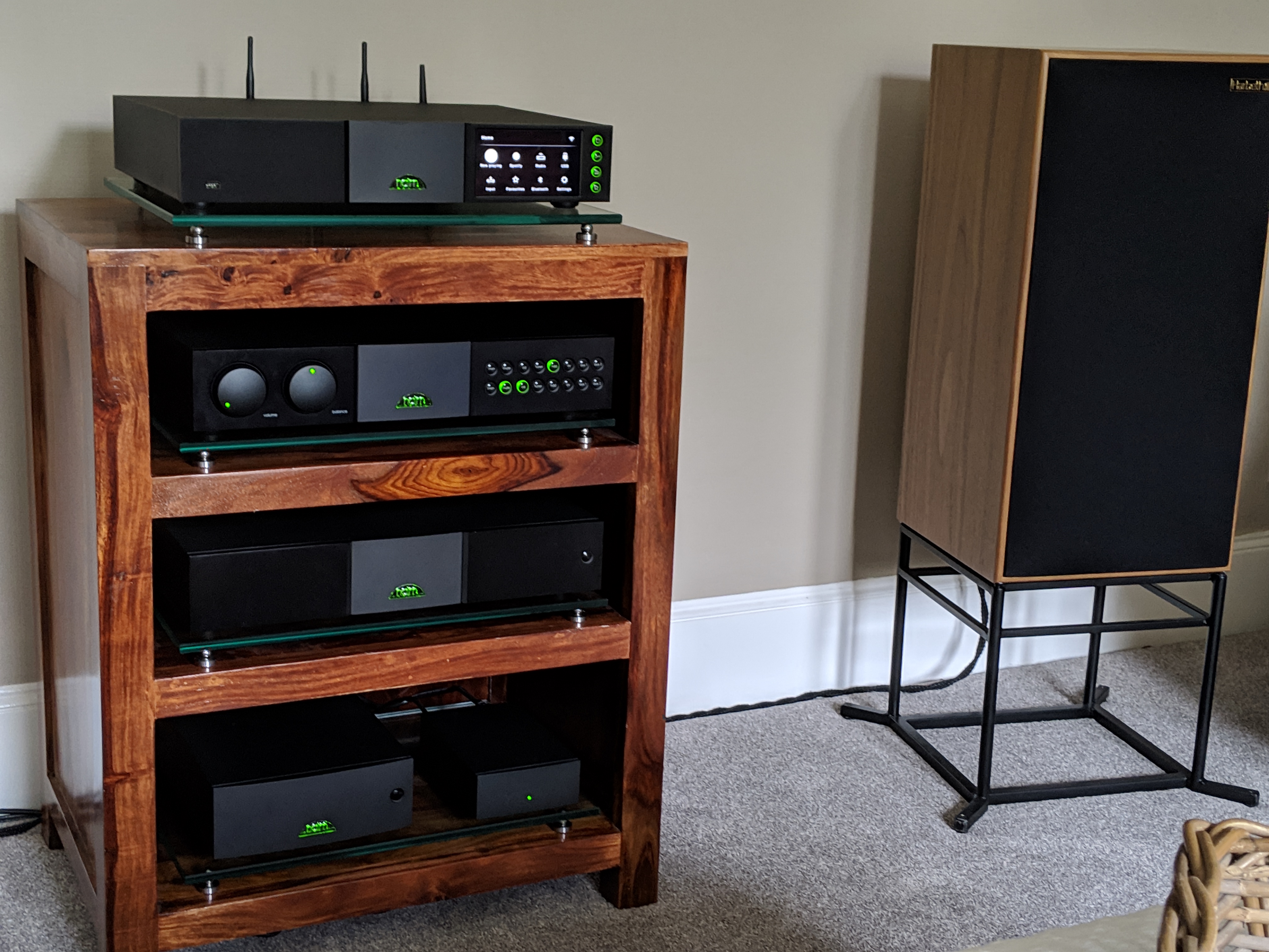

If this helps on sizes this is a 282/250DR. the very bottom rack has the HiCap on the left and the NAP on the right. A Supercap is same size as the"Normal" boxes.

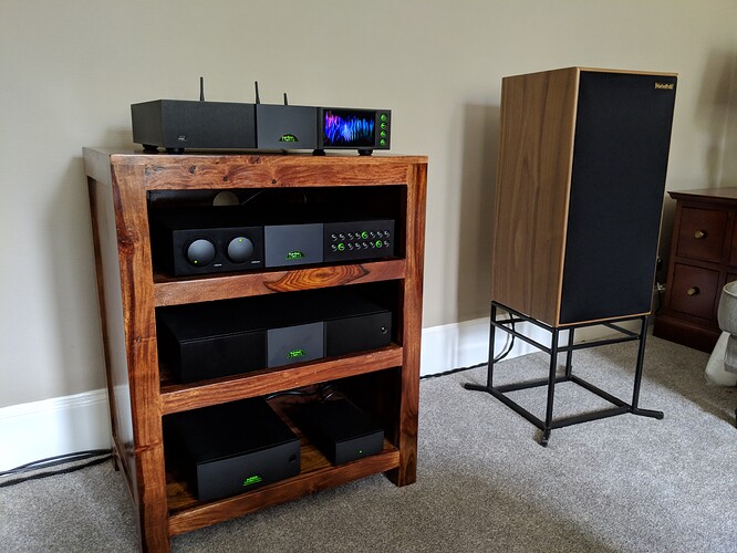

Another view of an NDX2 / 282 / NAPSC / HICAP DR / 250 DR based system. Gives you an idea of size comparisons.
