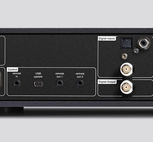

For system automation, connect remote out on the NDS:

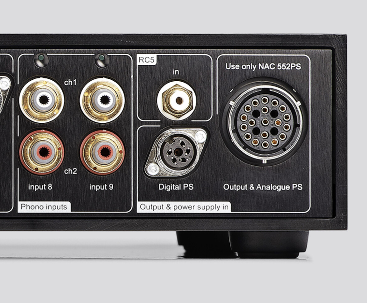

To RC5 on the 552:

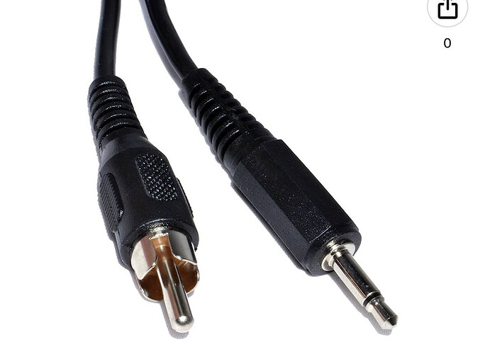

with a little wire - it looks like 3.5mm to RCA, and enable system automation in the app. You can then control the 552 from the NDS remote, or in the app. It’s very neat and makes life easier.
This little wire is £2.99 on Amazon:
