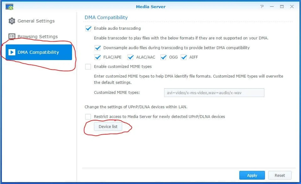

Thank you for your quick reply Mike and hope you’re well. Just to clarify when you refer to Media server transcoding being pants, I take your point about 24 bit and gapless but were you transcoding from FLAC files to WAV at that time on Media Server on your DS218? As I said, I have FLAC files on my DS216 NAS but cannot even see that the GUI has the option to transcode these to WAV. Perhaps it’s one of the few Synology models that doesn’t. I can’t seem to find a definitive answer even in Synology website help.
Hi again, I found that FLAC 24 plays as 16 when I first started & was experimenting at the time, that’s why I chose to go exclusively WAV.
It maybe that Synology MS doesn’t do this anymore, but it’s of no concern anymore with Asset UPnP.
As far as I’m aware Synology DSM works on all models, the how to do it instructions are in the Media Server section of the manual & online under DMA Compatability
It transcodes all the popular codec to either WAV or raw PCM which is practically the same (not sure which, but I’ve done it)
Open Media Server
& down to DMA Comparability
Check (tick) to enable transcode & also each of the codec you want to transcode
Do not check downsample
Apply
Finally - forget Media Server & go buy Asset UPnP

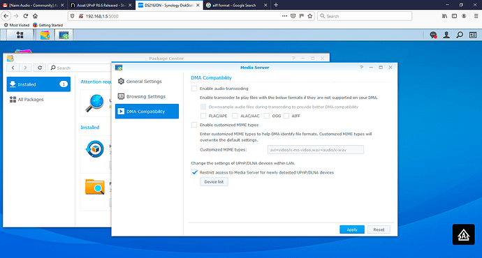

Mike, I have been into that DMA settings page of MS many times and realised it was almost certainly the only place where transcoding to WAV might have been possible, but it was not (still is not) obvious to me that by ticking any of those boxes it is saying that my FLAC files will be transcoded to WAV or PCM and then played as such on my 272. Sorry if I am missing something but by ticking those boxes (including AIFF which is PCM essentially?) all it is saying to me that it will play any of those formats if they are not “supported on your DMA”. But surely that is not a problem that I have as all those formats are supported on my 272 as far as I am aware. i.e. the 272 plays WAV and FLAC. I just want to effectively “convert” (maybe the wrong phrase technically) my FLACS on my DS216 to WAV before they are played on the 272? And if I have understood the MS tick boxes in this DMA section correctly then MS won’t achieve this and I clearly need Asset UPNP purely on these grounds alone?
2 other questions please Mike: 1) you HAVE checked downsample in your screenshot but as you say, I would not have thought that should be checked? ; 2) why have you circled “Device list”?
Here is my current screenshot (also note the restrict access box ticked at the bottom which has not ever caused any known issues but I cannot recall why we did this when I had the set up problems):
