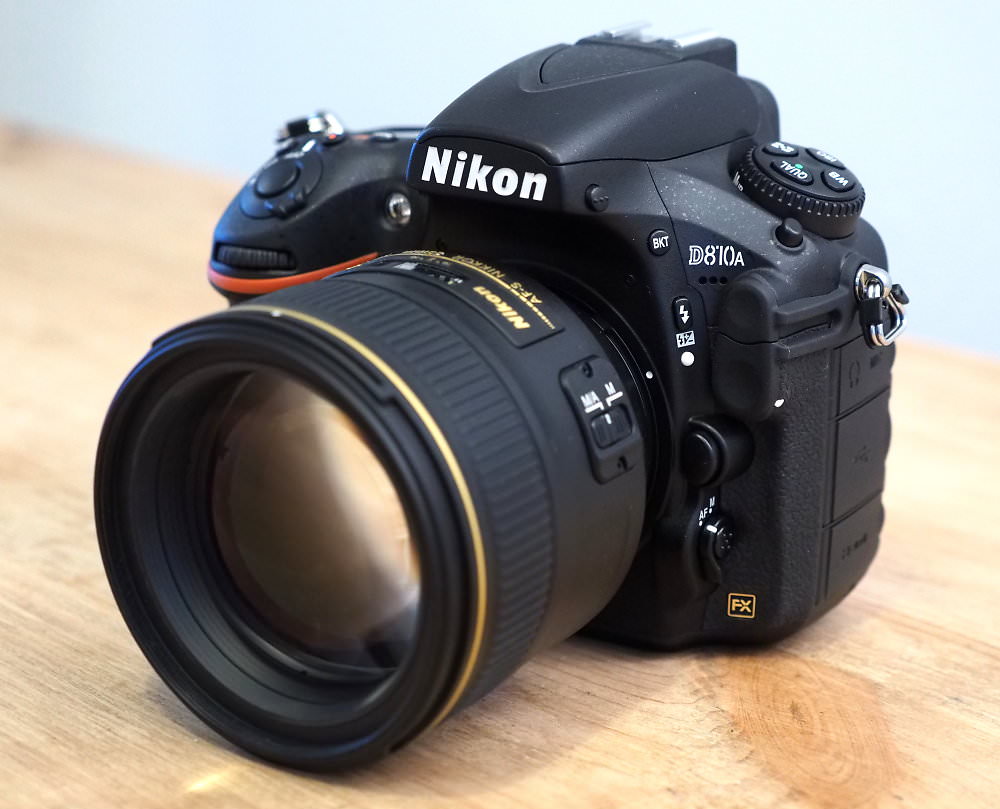

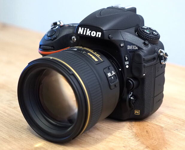

Just a reminder that the Nikon D810A was specifically made for Astro photography.
You should be able to find some good pre-loved examples available within budget.
ATB. George.
