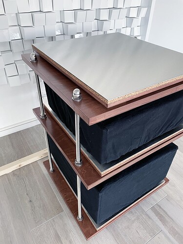

Take a look at the TNT audio flexy design. I made one a number of years ago and it works very well
We can even add isolation platform, home made or not, and efficient isolation feet.
That’s a my current temporary rack.
