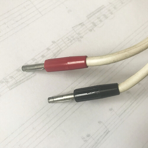

I noticed that there are three types of “Banana” plugs.
This looks like what Naim is using.

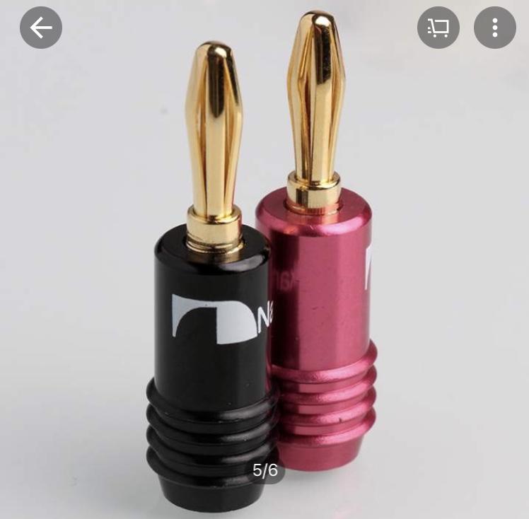

These are the other two types.
Are these other two safe to use for Naim amps?
Also, what would be better for Naim amps, gold or silver plating?

The best are Naim’s own speaker plugs, the sa8 and the similar smaller ones for units like the Atom.
Naim use I believe deltrons on the speaker ends, so if you have to, you could use deltrons all round. The nickel ones not gold.
But ideally use the sa8 plugs or the smaller ones depending on which amp you have.
Naim supply their own Nickel plated plugs with their amps. I would use those, but any regular banana will work.
100% right to have the original Naim plugs in a Naim amp - nickel into nickel
However the speaker end might need to be different. I found a dissimilar metal erosion problem in my ‘gold’ speaker terminals with Naim plugs.
I renewed the speaker terminal plates & installed ‘gold’ Deltron’s banana’s, problem gone .

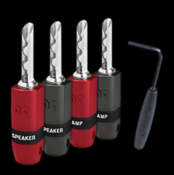

On advice of @JosquinDesPrez I’m going with AQ 500 banana plugs. Had not considered whether my NAP 500 really will be happier with nickel plugs at the amp end however.
One benefit to these AQ plugs is that they are user installable with screws and a tool they supply. Thus I can terminate them after pulling.

When I bought my Phantom cables I didn’t want the BFA style bananas (AQ 100 series they use by default), because I’ve had issues with BFA bananas snapping off too easily. They upgraded me to the AQ 500 series, which use more solid deltron style connectors. They told me the cable is too thick to use standard Naim deltron connectors.
