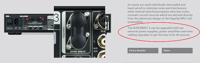

This isn’t the answer the OP should be looking for* but this merged screenshot shows what naim state on their website and the back of the SN3. Note ‘Upgrades’ and ‘power amp in’. You can just see the ‘bi-amp’ socket too from the web magnifier - as @ChrisSU points out - the other option which you have.
*However, as HH(Nigel) suggested, that level of expense on those speakers is an unbalanced way to start building a naim system even if they are your ‘endgame’ pair. I wonder what the total budget that @newcomer had at the start because it would probably be a very different system had he sorted out the front end first via a naim dealer with a cheaper pair of speakers.
