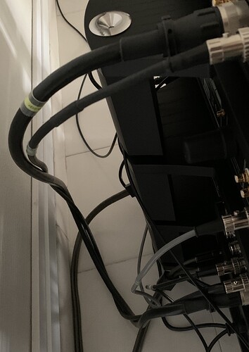

This is how I loop it twice on the cable. But somehow feel it is wrong and stressing too much on the cable. Some says need to go in parallels and just briefly touch will do.
THat’s what I’m doing. The only difference is my SCDR and 252 are on different racks so they hang differently, but I twisted the SNAIC around the Burndy like you did.

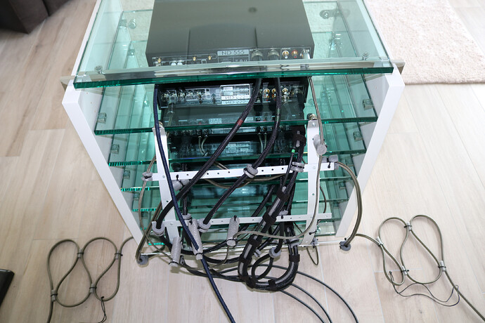

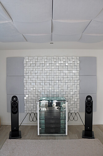

I use quite a different approach. I gently shape the cables, then attach them to an aluminium structure I tinkered. The cables then “rest” on foam loops which are attached to that structure. The cables never touch the rack, nor the floor (except for the PowerLines). This probably leaves some mechanical stress, but really not much. Like such:
(This is an old picture. I did some optimisations when I installed the NAP500DR)
Burndy and SNAIC from the NAC552DR run parallel to each other without touching one another.
Speaker cables simply hang on the air, touching nothing, using cheap threads.
May I said this is the best Burndy and SNAIC parallel dressing I see. Totally parallel and not touching. I got to find the foam to do it myself! Tks for sharing the picture.
