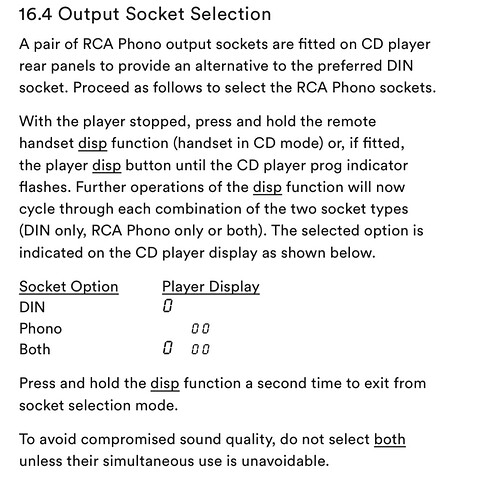

Just plug the RCA into the RCA for CD input below the Din socket.
Like For Like.
It’s not subtle :+1:t2:
In fact you can leave both cables in to compare just change the output by remote on the CDP.
You can keep the same volume setting and just compare.
I see the din at first as it came with it glad I tried RCA the din is deaf and dull.
I must apologize… but I didn’t understand…
How can you switch between the RCA and the DIN if both on CD?..:thinking:
Hi these are the instructions you want two 00 only for RCA
If just connect RCA without selecting you get nothing.
The CDP from the factory is set to din you have to tell the CDP where to sent the tunes.RCA output.
If you have both connected you can use this switching method to compare.

Yes you can keep both cables in but it’s a compromise. The advice is to have only one connection to avoid messing up the earthing arrangements.
Leave both in to compare then when the decision is made remove the unused ones.
And select only one output on the CDP :+1:t2:
