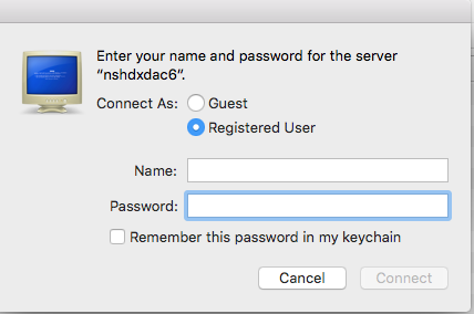

Maybe I have to change something in the settings?
I am doing it on a Mac, can’t use web browser to access it because of flash
As Chris says, you can use no username and no password as the credentials, ie leave both fields blank.

Leaving blank deselects the “connect” button
