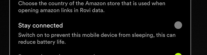

A work around if you have certain iOS discovery issues with your Wifi access point, and you can’t follow the Apple support recommendations, or they make no difference for you, is to nail the connection up to avoid the need of subsequent discovery sessions in the Naim app.. but increases iPad / iPhone power consumption, but worth a try if you are really stuck.

btw I’ve fixed the issue with intermittent finding the streamer when the app comes out of standby/wake-up… I’ve installed a free app that keeps the tablet awake all the time - brilliant. Never misses a beat. No delays at all. Instant.
But probably best to see if you can fix the underlying issue… as your battery life on your tablet will decline if it’s having to be on all the tine, even when it shouldn’t be required,
It sounds like there is an issue somewhere that sooner or later you will run into again perhaps with another amplication.
It’s a bit like putting Radweld in your car to stop a leak , it will get you home fine or last a holiday, but you want to get your car fixed.
