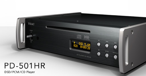

My Teac PD 501 HR plays DSD in native format, and sounds stunning. It plays DSF or DFF files, which I have to burn on DVD recordable discs. Analog output from the back of the teac, no conversion needed, or DOP packaging.DSD in native format is basically the same as an SACD disc, and they sound very good.
If you like sirupy, caramel like sound, it sounds great indeed
Sorry, but what do you mean by ‘sirupy, caremel like sound’? Making blanket statements like DSD sounds bad on Naim is really unhelpful. Unless you’re making like for like comparisons then this is meaningless.
Oh dear that sounds rather damning of the equipment playing back DSD. What are you referring to?
