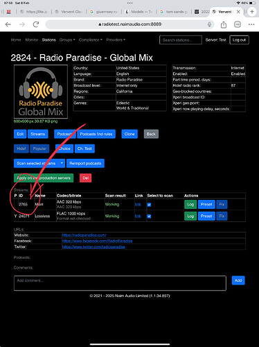

When presetting a station that is known and managed by our radio system, just one reference is stored in the product - the streamID
Here is an example station. All that information is stored on our backend servers and the product just references the ID marked up in red.
If a user wants to add their own station all those details in the above screenshot (+stream url) has to be stored somewhere.
  • the older products don’t have the free storage to atore so much info. They only have reserved space for preset that reference a station stream number..
  • on the older system (vtuner) stored it on their server and then assigned a unique id to it. But as mentioned above, as soon as we introduce user accounts / store information owned by customers then we need to obey all the data protection laws that are out there.
