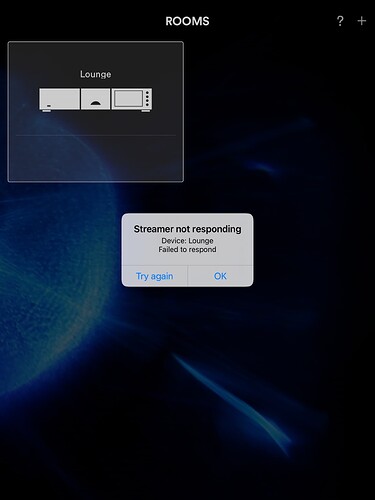

NDX2 has been showing flashing power light since trying to install the update. Continuously 4 flashes followed by 2. When I select the room in the App it is displaying message that streamer is not responding. It’s been doing this for 10 hours now.
Guessing a reboot will be a possible solution unless anyone else has another!

Update.
Used the usual IT solution. Turned it off at the mains and powered it up. All sorted. The update has installed and appears to be working fine.
