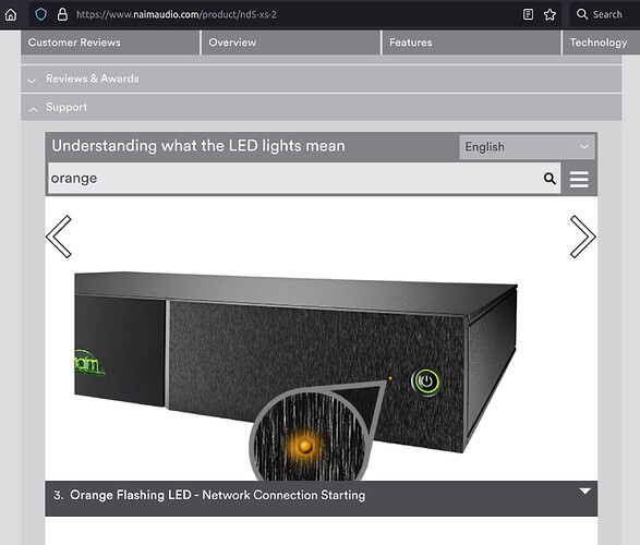

I own two ND5XS2 both on 3.7.0 and hard wired, android app the latest revision.
Decided to apply the 3.7.1 update individually just in case one of the ND5XS2 bricks!!
First one updated without a hitch took 5 min, the second updated but has a flashing (what appears to be an) orange light but plays tunes as it should, system automation works too.
I will power off later but why the difference between the two units?
I don’t have a nd5xs2 but the documentation says “network connection starting”. Not sure why it’s playing
. I’d try pulling and replugging the cable, and rebooting it if that does not help.
My NDX2 has been stuck at the “Firmware update Downloading Firmware” screen for the past hour. It’s connected by ethernet on fibre broadband, the download was started at 6.30am. Good old Roberts radio on Radio 4 duties this morning instead.
Further to my post, last night I pulled the mains plug for 30 seconds then reinserted the orange light stopped flashing but my question is why two ND5XS2 on the same network, same firmware, same Android mobile running latest app have two different outcomes.
Even though the orange light was flashing the device performed as it should, weird.
Appears to be “Ghosts in the Machine”
My NDX2 did the same. Removing the power for a period (overnight in my case but I would think 15 - 30 mins would do it) and it updated happily and quickly. The Nova was fine at the first attempt.
I suppose the network must actually have been up (or it would not have played) and it might have been only the LED that was confused.
