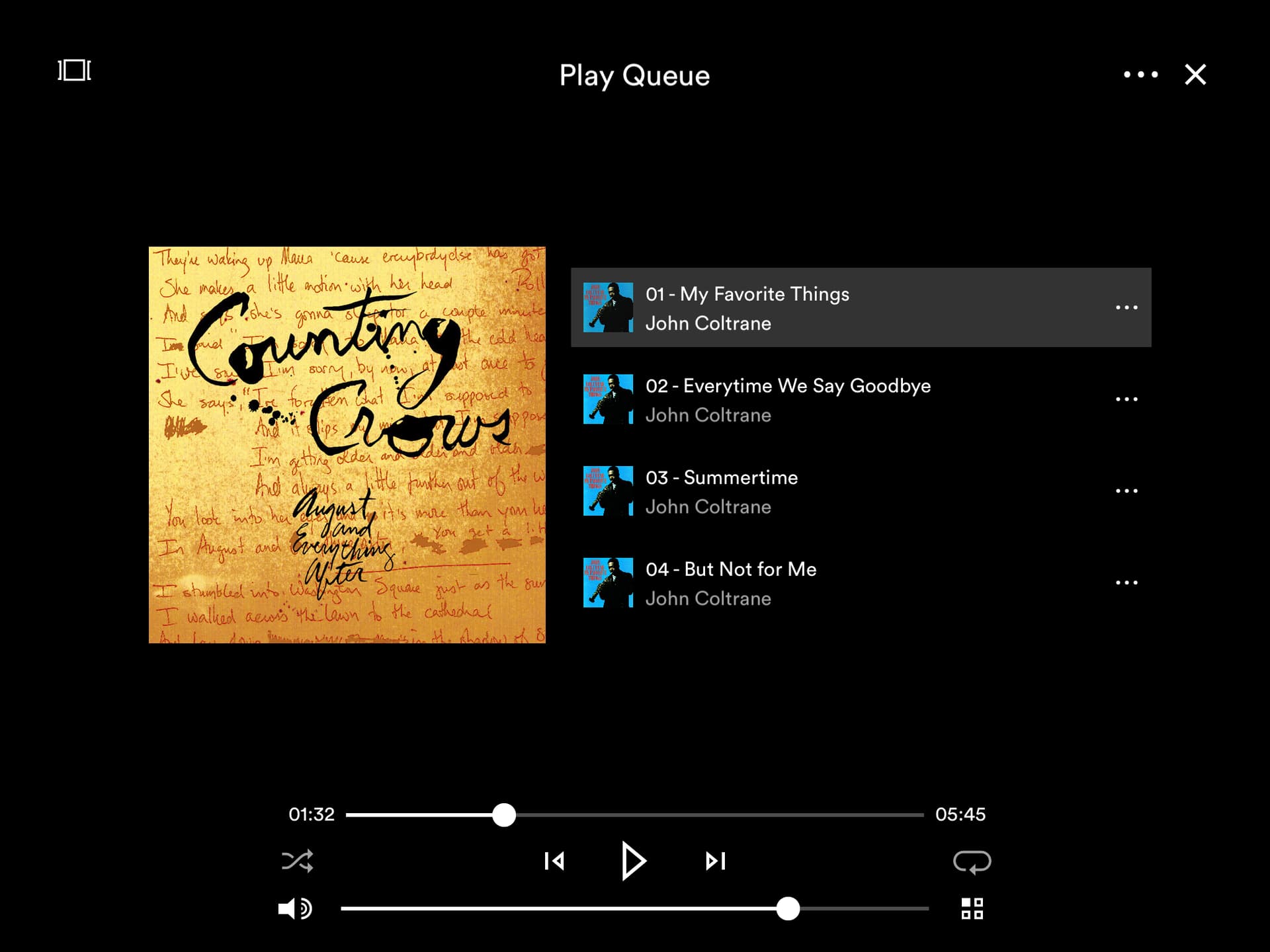

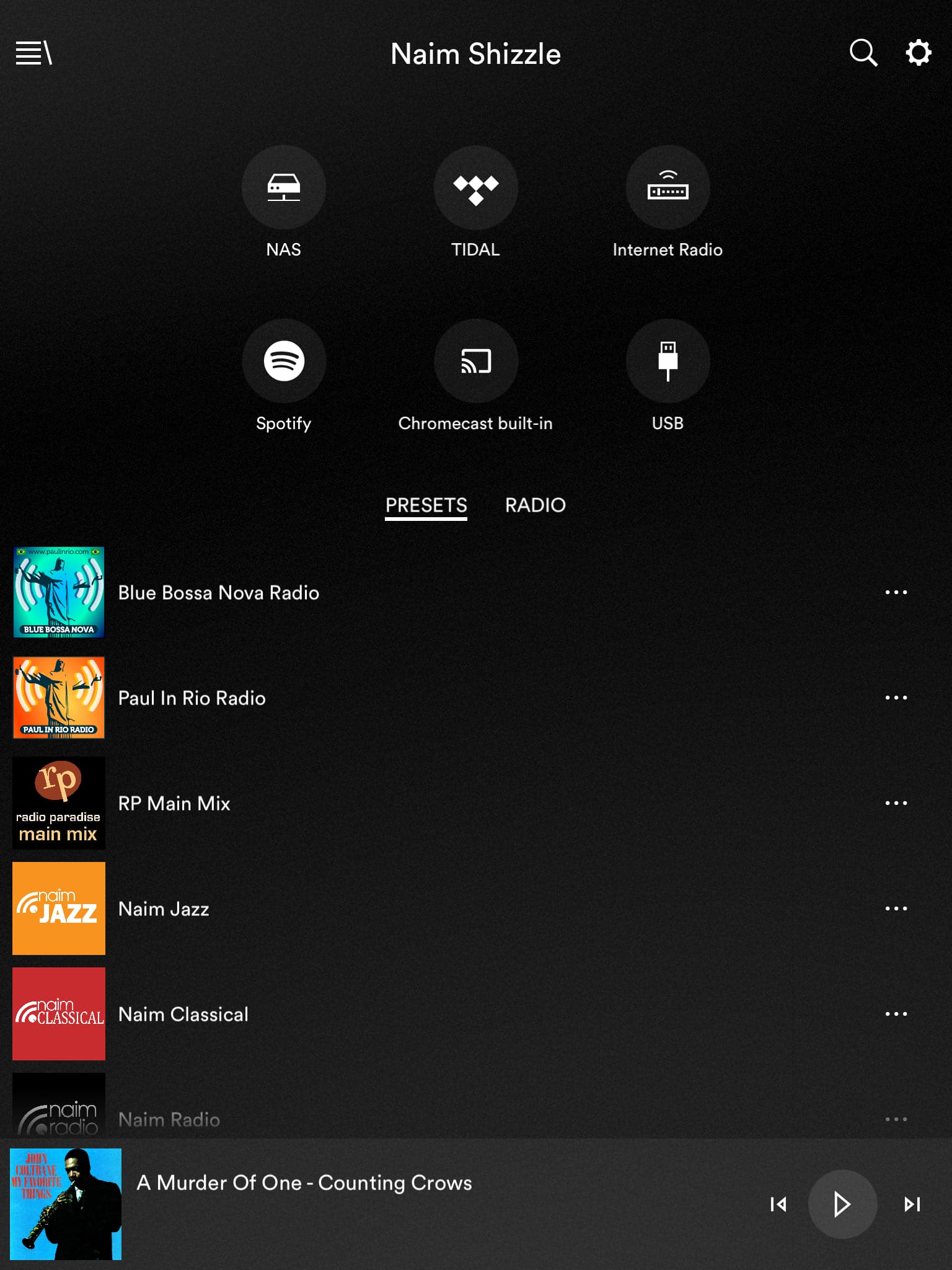

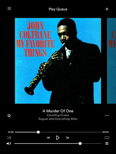

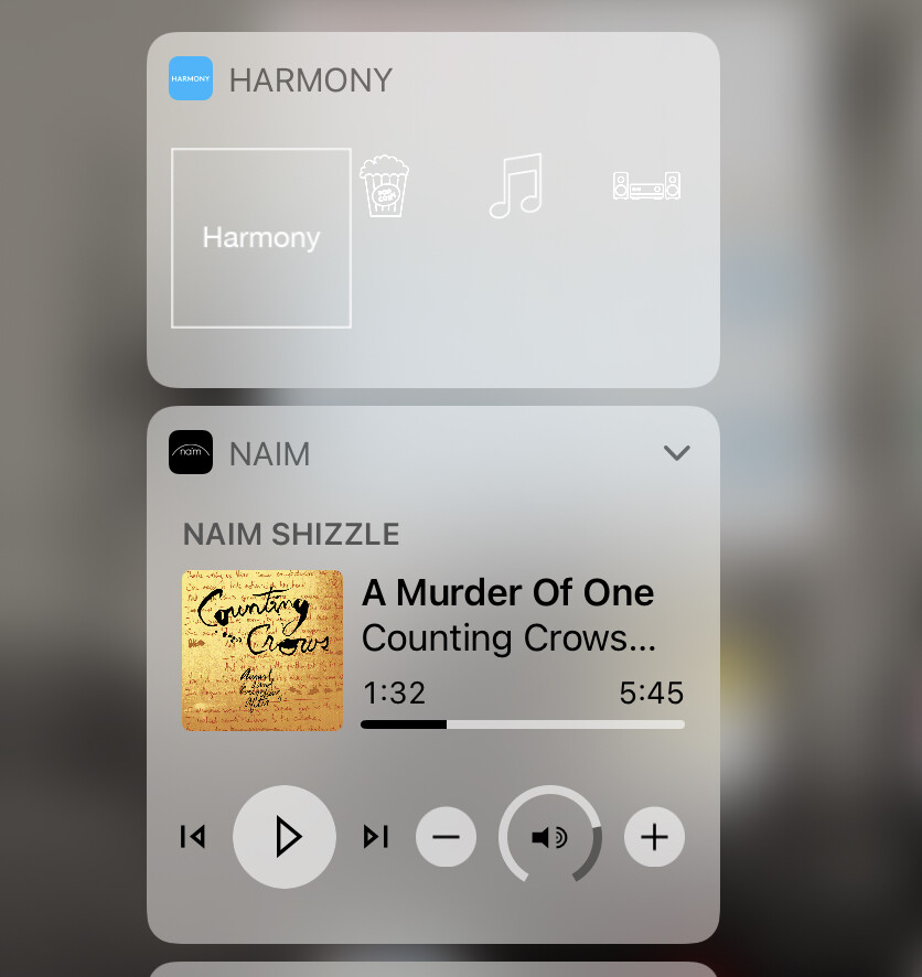

Happening right now. Played Counting Crows this morning, started playing Coltrane now. It looks like this:
Widget:
The timer does nothing, it indicates 1:32 and just stays there. After the first song ends, it freezes. After which I start the album from song two by pressing it on the playlist and everything works fine after that.
