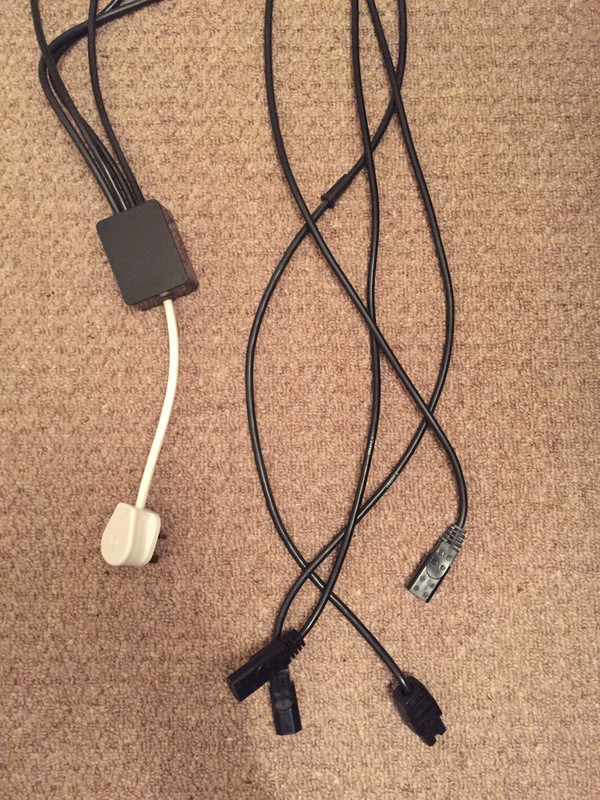

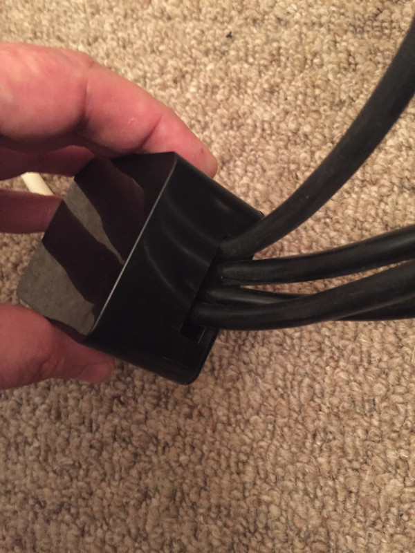

Easy to do. For many years I used a four headed version that looked like this:
But when I wanted a six way version I rebuilt the whole thing from scratch and a bit more obsessively :).

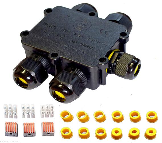

I spent the morning connecting up all the its for the DIY Hydra from Belden 19364 cable, the shielding connected at the plug to earth, then the junction box shielded with copper tape, all shielding wires soldered together and connected to the box shielding. My mate across the road PAT tested them for me so they are all good and 100% safe. Despite being super thick the cable is very pliable, far easier to work with that either the standard or Grahams Hydra cable but with all wires cut to length for each bit of kit on it’s own shelf the big gain is in plain old tidiness, all the mess and tangle of wires has gone, just 2 runs from the socket to the underside of the racks and the four leads within the rack all neat and in place. There is now loads of room to organise the other interconnects in a relatively tidy fashion, surely that must make a difference but how remains to be heard, I’ll report back when the amps are back in place and run in again
Did you take any step by step pictures?
No, I thought DIY wasn’t really the done thing here, but basically it was a case of cutting to length and soldering the same colour wires together and insulating with heat shrink.
This is the junction box I used which was easy enough to shield and connect everything together. It did come with connectors but I preferred to solder them instead
