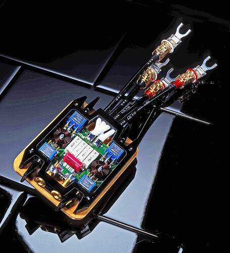

I believe this is one of those cables with a box of electronics attached so I suspect not. :face_without_mouth:
I believe the Gran Finale cables have ferrite blocks rather than electronics in the box. Whatever, I’d question the sense of using $2,400 speaker cables with a Nait XS3. Using good sensibly priced cables such as NACA5, TQBII or Witch Hat Phantom would be a much better balance, especially when you consider that the speaker cables cost more than the CD source.
The ferrites are all along the cable, not in the little box.
Who knows, but why would you want filters or whatever between your amp and your speakers? All they can do is act as a tone control. In my humble opinion it’s bollocks.

I looked at the HMS website for the specs. This is for the “Gran Finale Ls Jubilee”, the only Gran Finale that I can find there:
Inductance is 46.6 nH/m, Capacitance is 2.1 nF/m
I leave the math to you, but it does not look good to me at all
I.e.,
ensure that the cable is low capacitance and of moderate inductance
This one is very high capacitance and very low inductance (it is listed under “low-inductance speaker cables” in the price list):
Inductance:
46.6 nH/m (that’s n as in nano), equals 0.0466 µH per meter if the website is correct
NACA5 has 1 µH per meter, with 3.5 meters minimum and 5-10 m optimum, i.e. 3.5-10 µH.
Capacitance:
2.1 nF/m (also n as in nano), equals 2100 pF/m if the website is correct
NACA5 has 16pF/m, i.e. 56-160 pF with 3.5-10 meters
I think this cable is a new record holder amongst “not for Naim” speaker cables.
I’ve thought I have seen it all :face_with_raised_eyebrow:
It’s like a small city in there.
