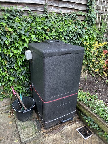

We’ve had a Hotbin since 2012. Brilliant thing. We put all our food and garden waste in and every 3 months or so the bottom section gets emptied. It has a removable front panel and so about a third of the bin is emptied each time. It cools down in the winter as less waste goes in and the worms take over (runs at about 20’C) and the as more waste goes in through spring and summer it runs much hotter (it was at 65’C earlier this week) and the worms head to the cooler base. No smells, no pest problems and the compost it produces has really made a big difference to our garden.
First, the trick with composting is get the ratio between carbon © and nitrogen (N) correct. So if you mainly put in kitchen waste I would add torn up cardboard. Start with a 1:1 ratio by volume. If you don’t have cardboard torn up newspaper will do. Don’t forget to give it a hose every now and then too. If it becomes too slimy add more C, if too dry add more N.
Second, hot bins. I don’t have one but I have researched the matter carefully and discussed with a friend on Sark. Sark is relevant because waste collection is predominantly for recycling. My friend uses two hot bins, solely for kitchen scraps as his kitchen garden and hens contribute to the garden compost heap. His bins can compost meat scraps, cat and dog litter, as well as tea leaves and coffee grinds. However, some of the cheaper models don’t perform very well; in any event you need to balance N and C.
Third, worms. There are specific composting worms that speed up the process. These can be bought and added to your scraps but they are fussy.
In short I would persevere with you composting, but add more C and perhaps a handful of worms (available online).
If you can insulate the compost bin, it definitely helps the organic matter inside to break down quicker. I accidentally found a good little trick when I’d emptied one of my old plastic bins (as supplied by our council) and temporarily stacked it on top of a half-full one, giving a double-layer of plastic with a slight gap between.
It was the version that james_n shows that got my interest, it appears they are not currently available.
It is the ability to add cooked food, bones and cat litter (wood pellet, not clay) that interested me.

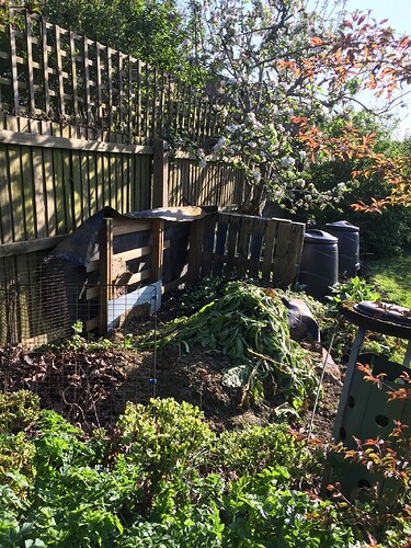

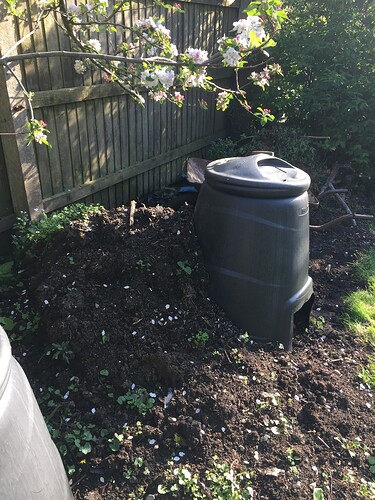

We were provided with bins by our council some years ago. With a garden the size of ours we need more. Very interested by @Camphuw’s comments. Not sure what provided the N. I do cut the comfrey down when it gets to big and bees have had a good feed. I try to keep grass and good clean greens separate from the weeds we have to clear. I have barrow loads of composted weeds. We bonfire coarser material including prunings over winter.
Our council collects kitchen waste weekly for its digester. We also get our electric from the local recycling incinerator.
Phil
The grass heap with a section for leaves. We also discovered that the slow worms liked the bins so we stopped putting stuff in and drew the compost from the bottom.
I could also add that my wife heaps the hazel and other larger prunings which provide a wildlife habitat and do gradually break down just as they would in a wood. From time to time she tramples on the heap to speed up the rate at which it sinks. The decomposed material is very light. If you have space nothing needs be taken to the council recycling centre.
Phil

My success is obviously in need of further study (not) but chicken muck & pig pee from the farm up the road seem to do it well & faster than anything else I’ve tried.
One of my neighbours uses several large hot bins for composting and they swear by them… most organic things can be broken down…
The only consideration I am aware you have to keep them constantly on the go
Thank you for this, it gives me some answers, too much brown and a variety of grass that sticks together, hence the slime.
I’ve looked again at making my own hot bin, it starts to add up, three sheets of sterling board, bituminous paint, rockwool slabs…
I did this because my garden is small, 20 x 40 feet, the waste is disproportionate mainly woody hedge trimmings. I’m going to have to dig out my existing bin, seems that the people who put in a new fence stacked the earth from the post holes around it, about 12 inches deep. No wonder I am not keen on the garden.
