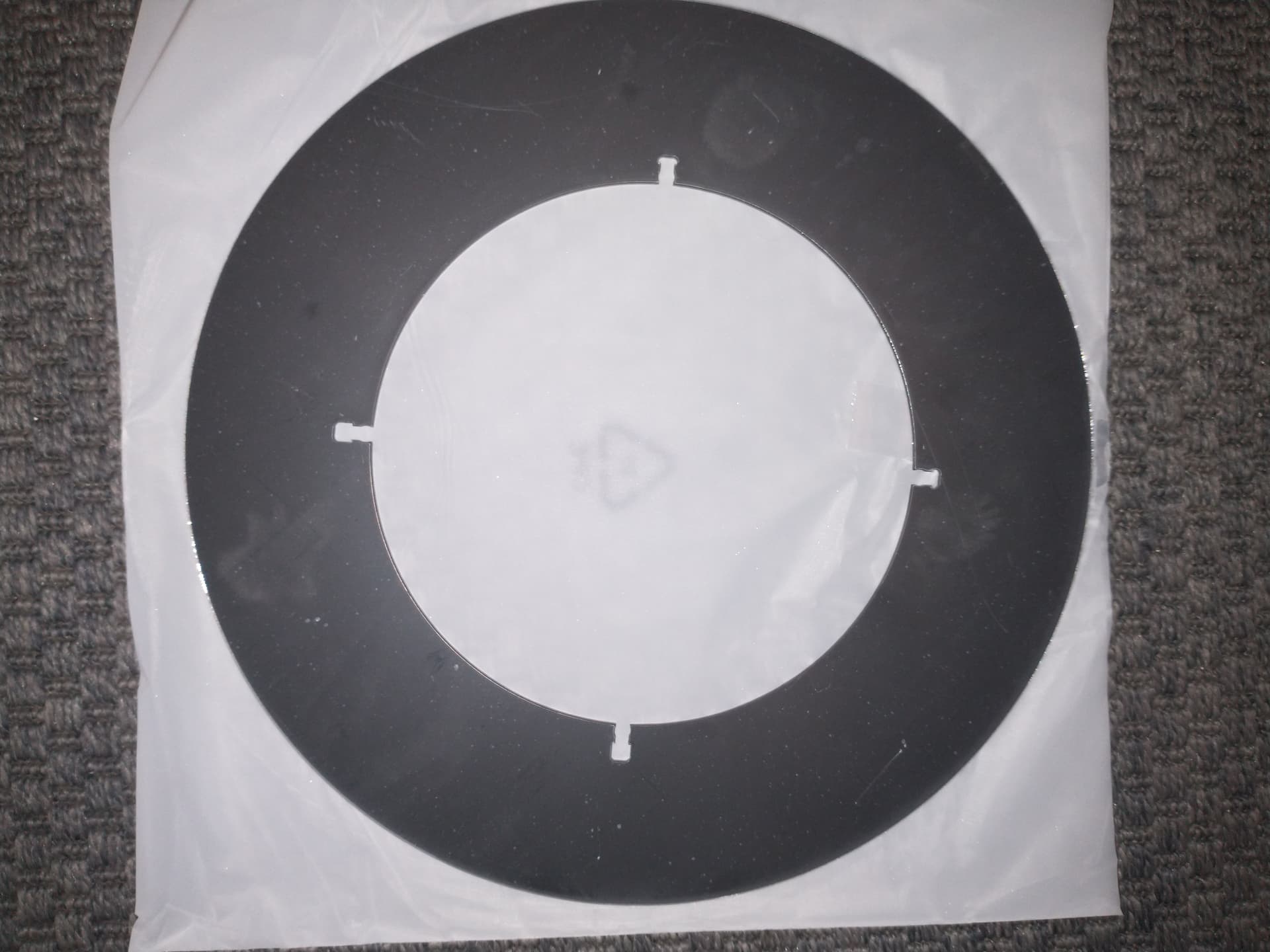

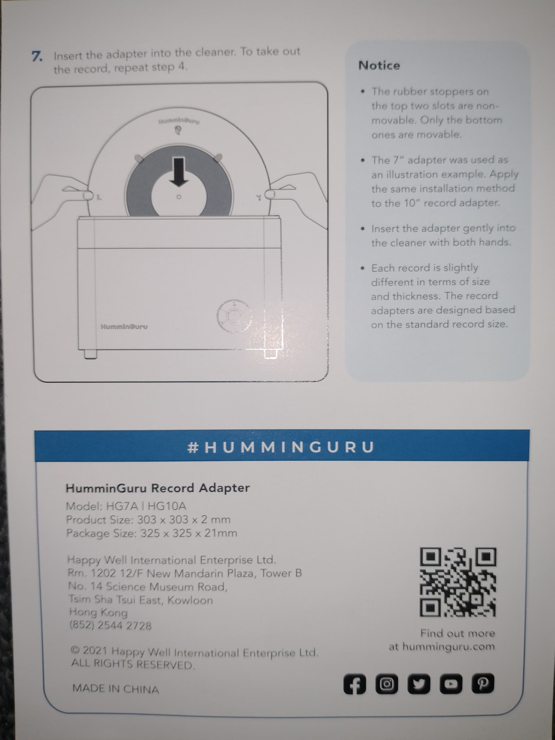

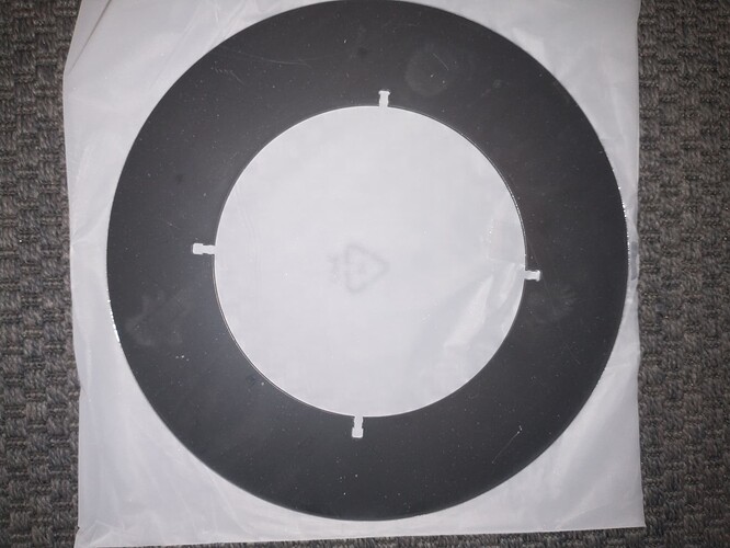

The 7" adapter, there’s also one for 10". (They were included for Kickstarter backers because all the stretch goals were met, are probably extra for normal purchases):

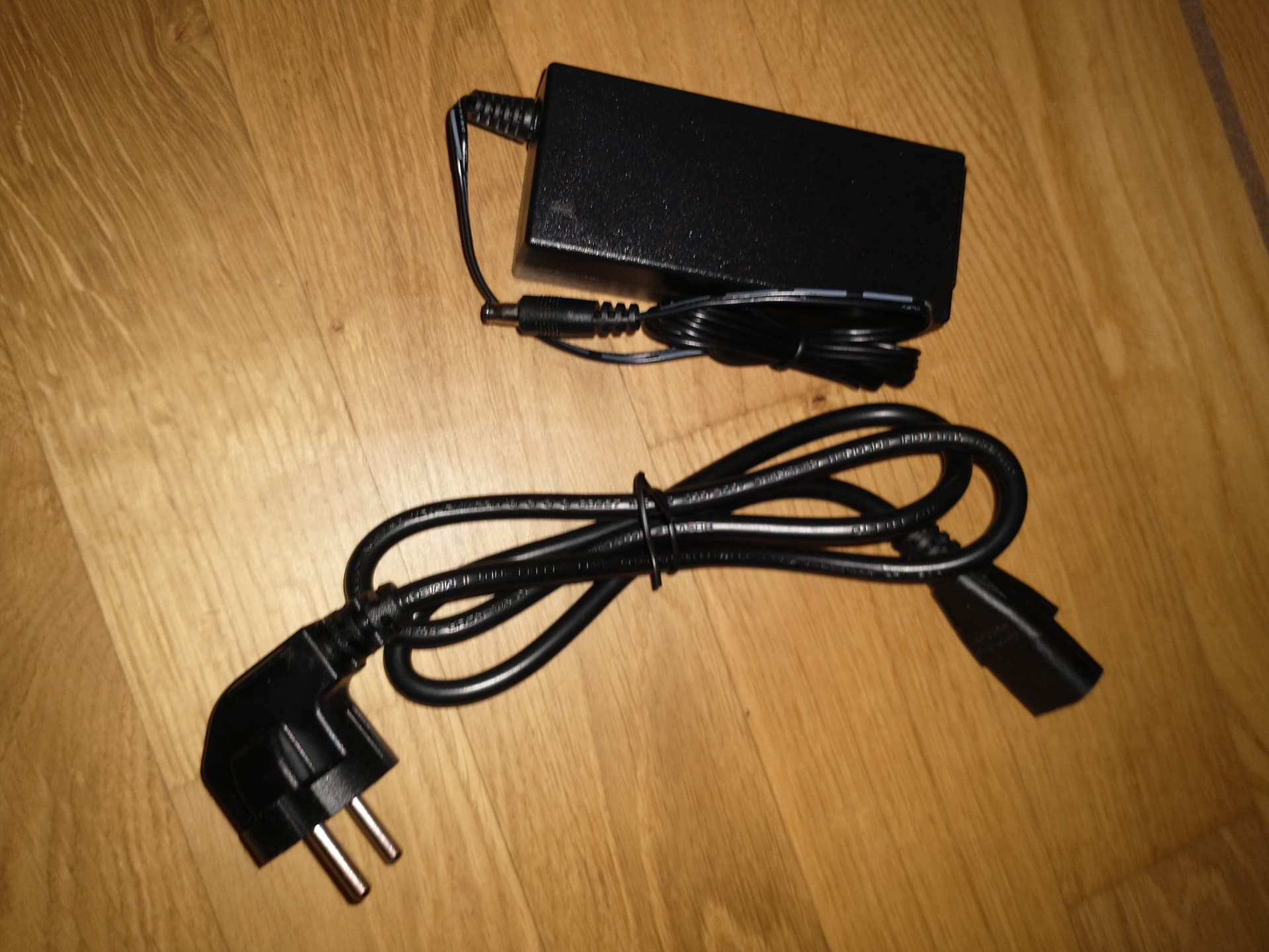

The included switch mode PS, but I’ll get a linear one for 5K to see if it improves the cleaning result :crazy_face:

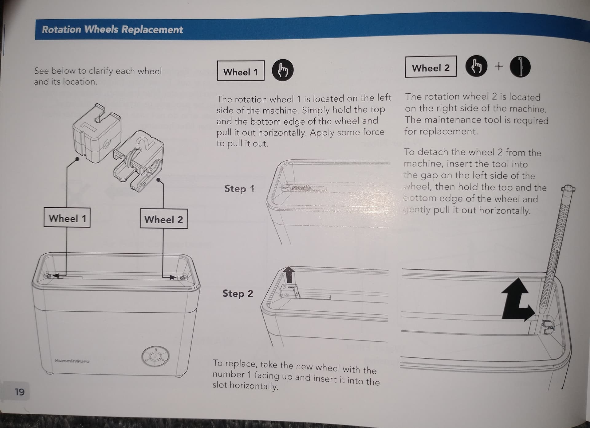

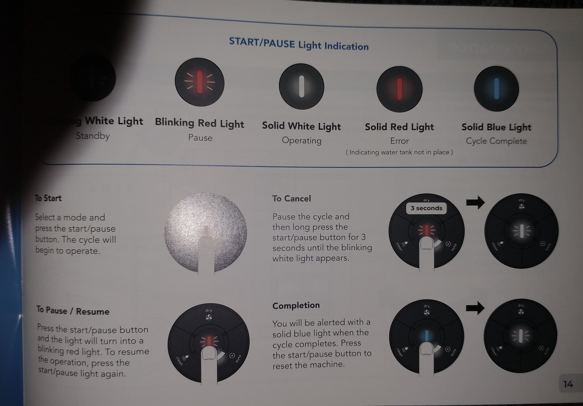

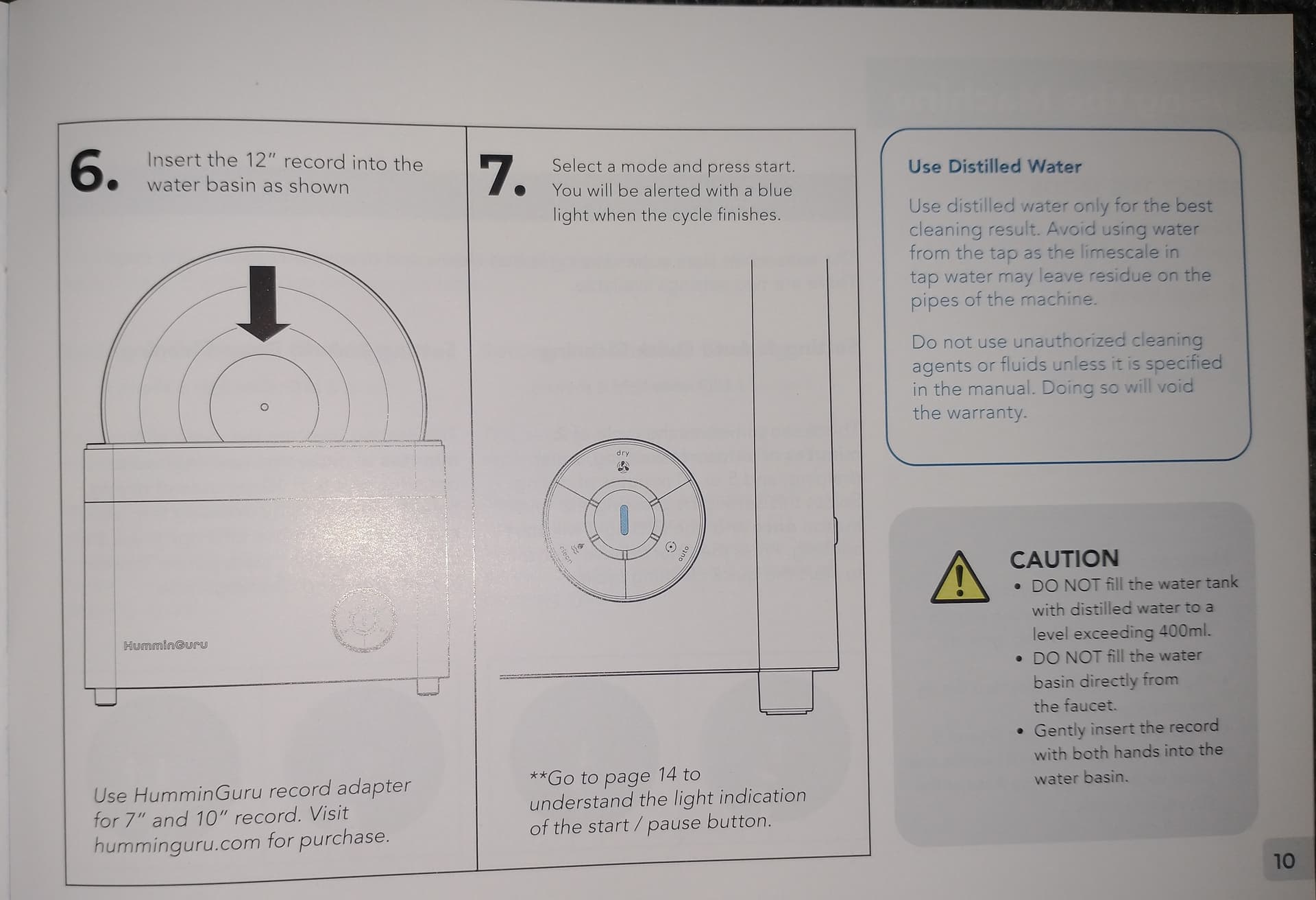

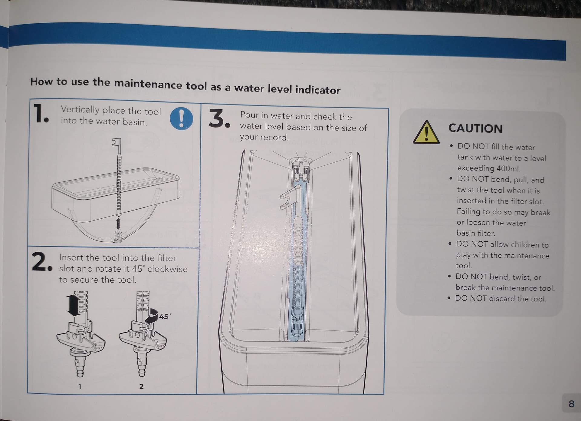

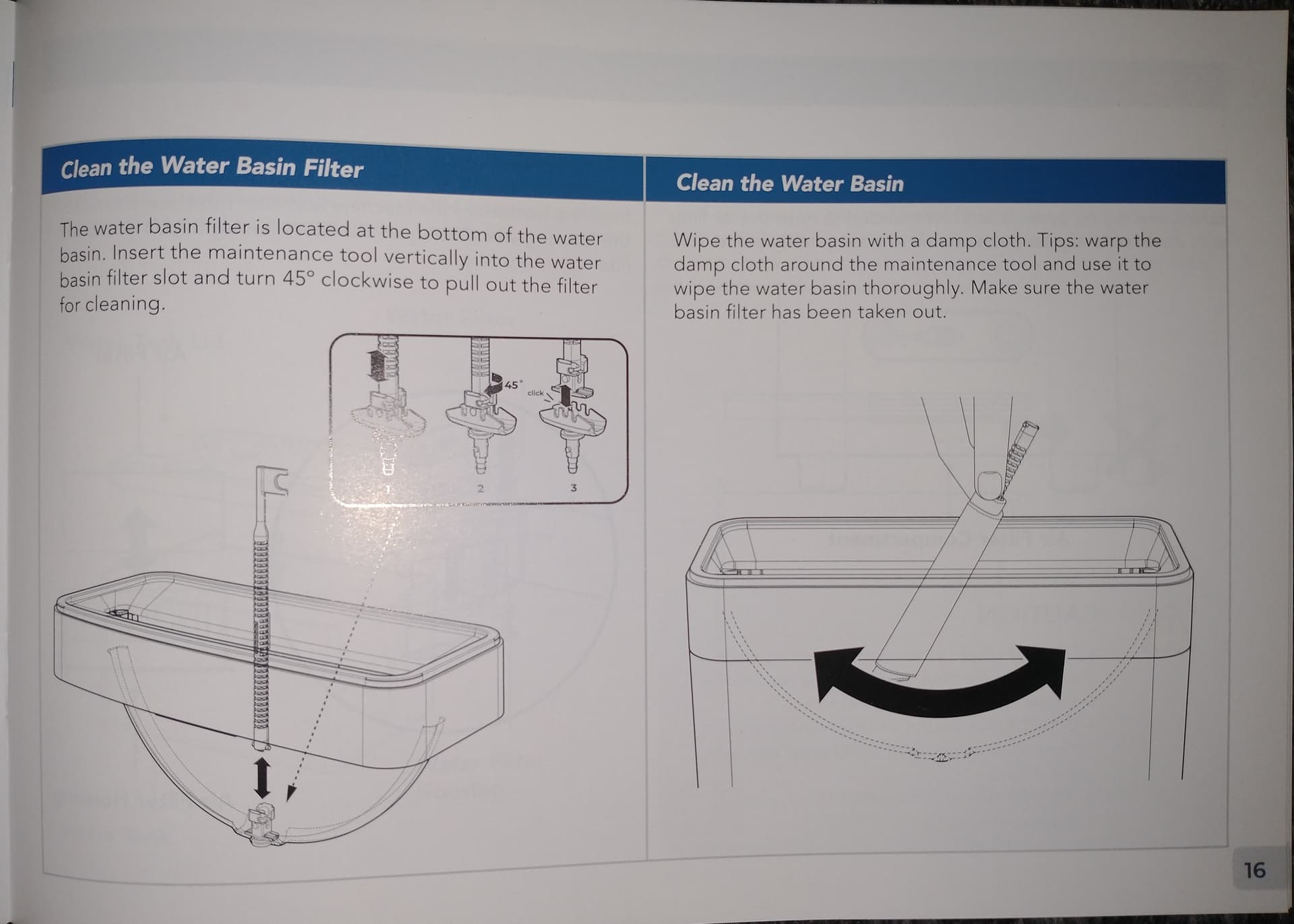

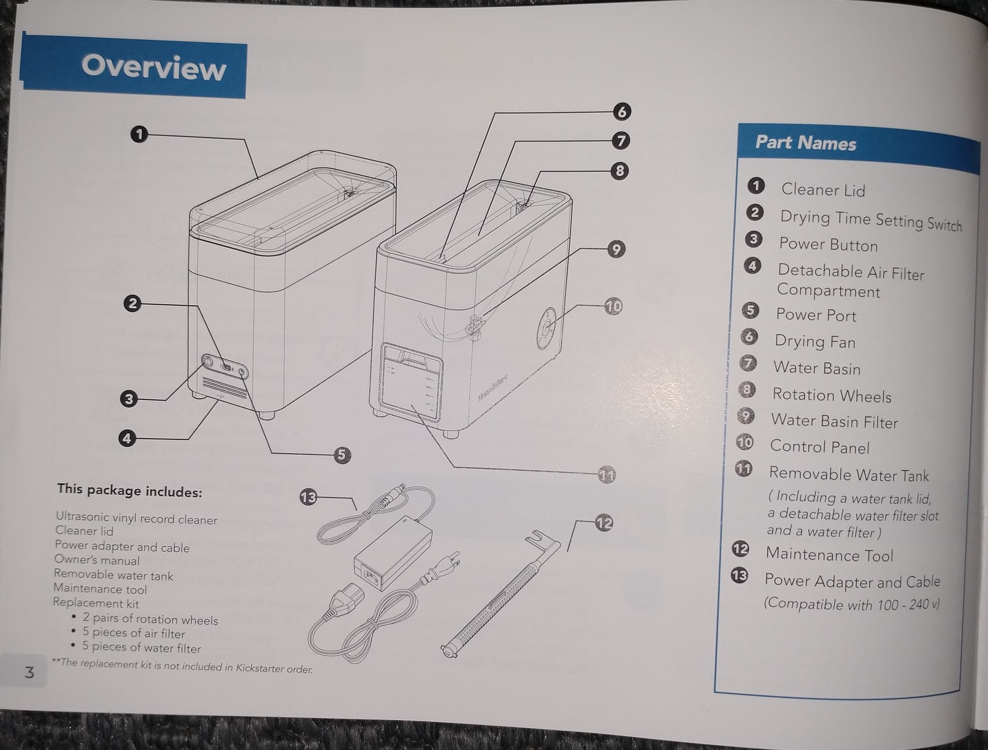

Manual, excuse the occasional fat fingers:
First two for the adapters:

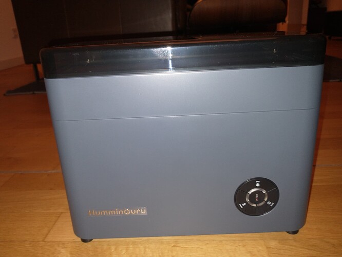

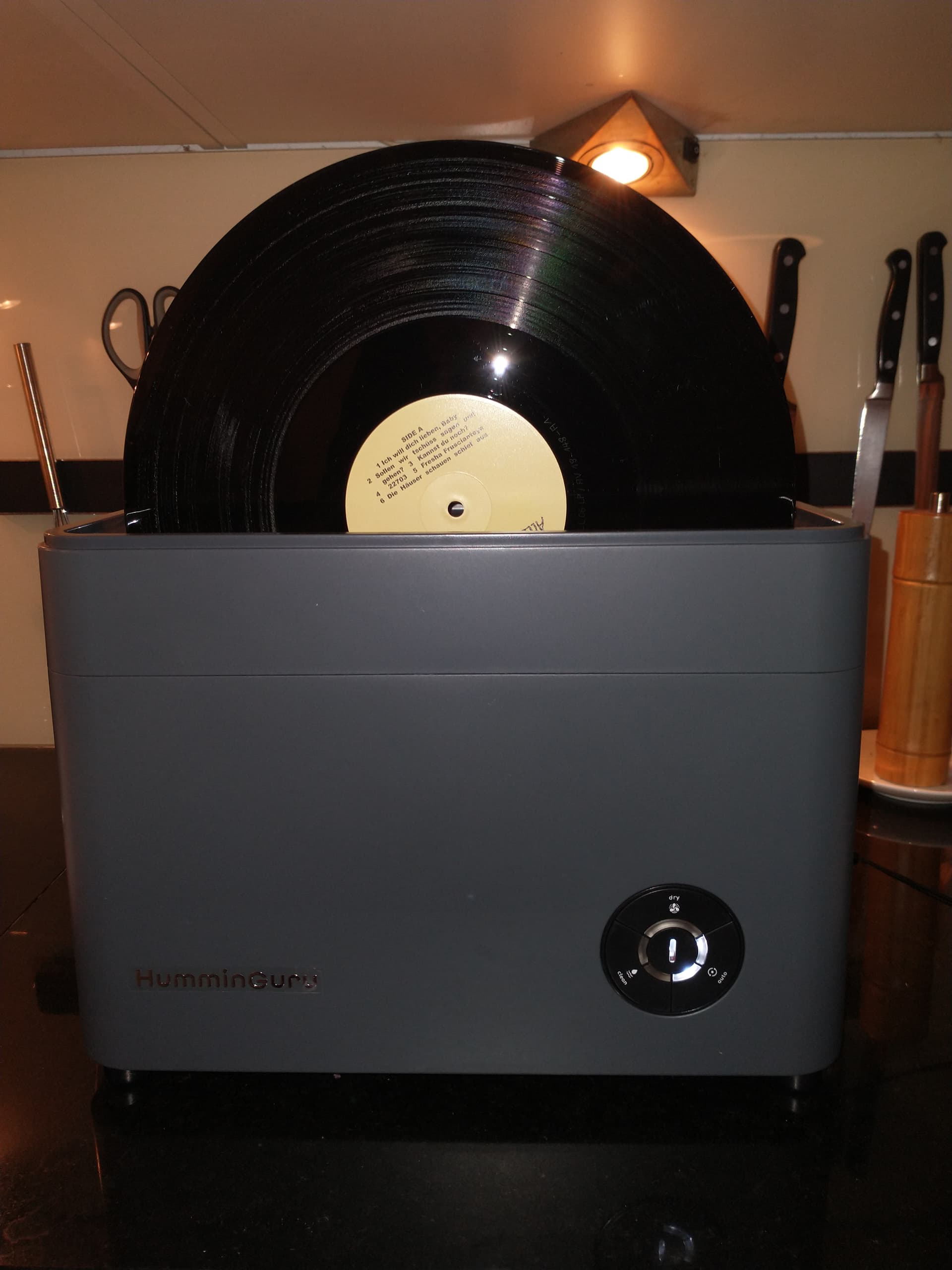

And the RCM:

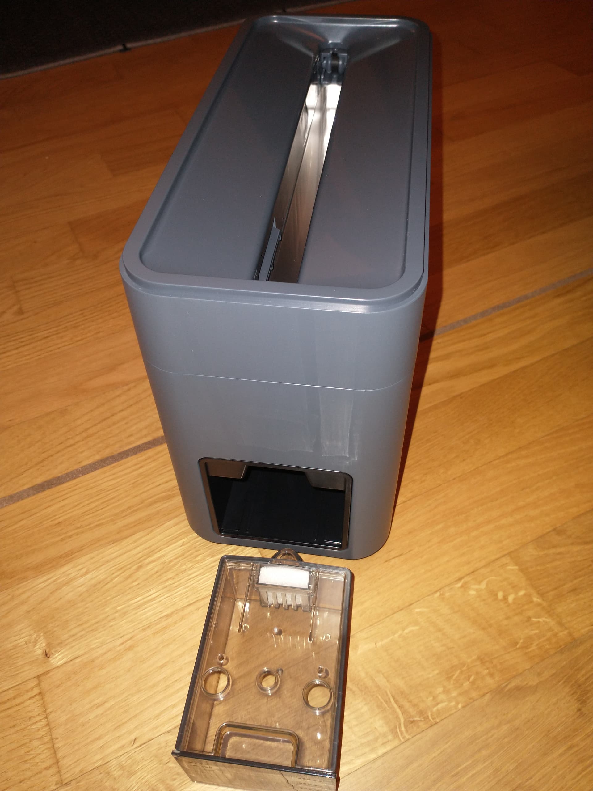

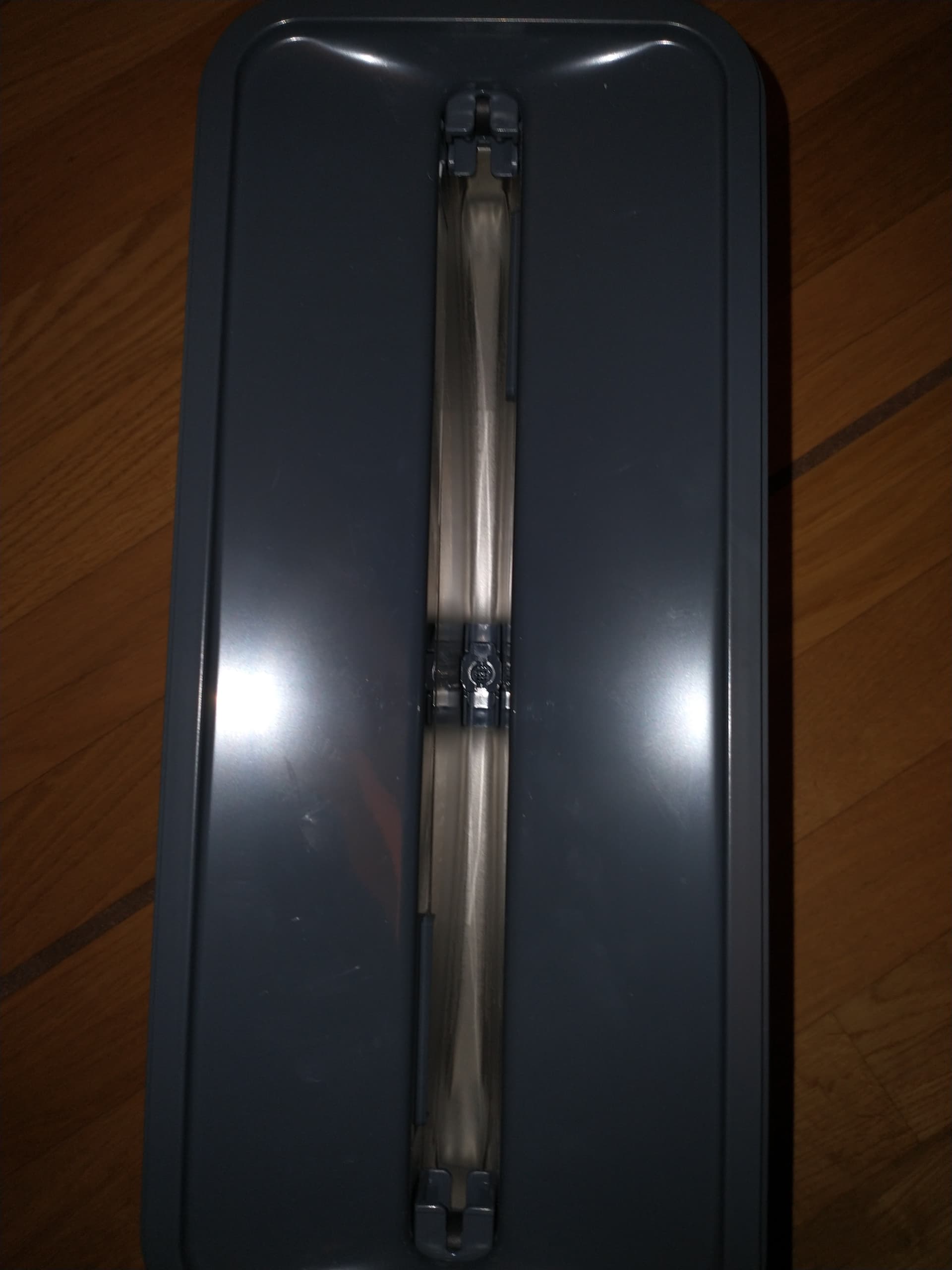

And the first cleaning impressions:

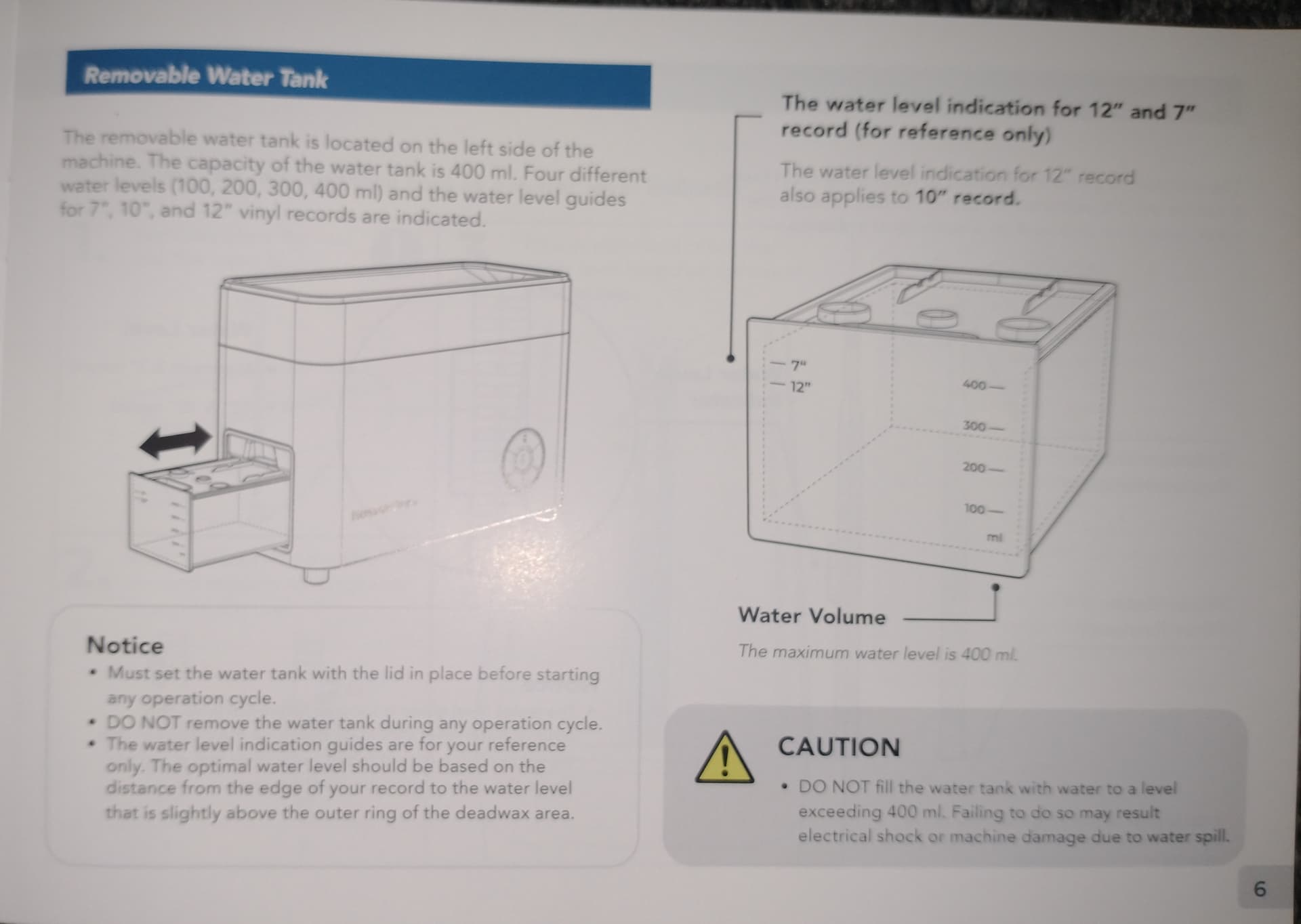

  • Quick and easy handling, you pour the water into a little removable tank (which also makes it the correct amount), fill it into the slit from the top, after the cleaning cycle it’s pumped back into the tank automatically. BTW forget about the maintenance tool used as a water level indicator - you want 400 ml exactly (it’s marked on the tank) for 12" records, then the water level includes the run-out groove.
  • There’s a washable, replaceable water filter at the entry of the tank, and an also washable/replaceable air filter for the drying fans.
  • The 400 ml water is a sufficiently small amount that simply replacing it after each run is possible, at least if you only clean records for immediate playing. It’s easy to remove the water filter too.
  • Default of 2 minutes washing and 5 min drying was enough for me
  • The noise is surprisingly low, much better than the ultrasonic cleaner I used previously (which was a regular 5L ultrasonic cleaner tank with a rotating spindle on top, cheap from Ebay and similar to the one sold by Kuzma).
  • The buttons for choosing options and clean/pause have a bit of a flimsy feel to them. Is not an issue and I am sure they are adequate, but a proper hifi company would have invested more where it really counts, in expensive-feeling haptics :wink:
  • Cleaning result seems good so far. I cleaned 2 new records that were not cleaned before. They were not noisy to begin with, but a cleaning run clearly improved it. All my other records were ultrasonic-cleaned with my other machine during lockdown. I cleaned one of them and can’t say for sure if there was another small improvement - may be. I am now searching for a dirty one I may have forgotten somewhere.

  • Like with my previous cleaner, the water level should nearly reach the label, so that the run-out groove is included and any cat wool in the area is reached by water, else it stays there, obviously. This is the case when using the 400 ml water mark on the tank. No worries, the water does not run down and reach the label during cleaning rotation.

Originally they recommended to change the water after each LP, if I recall correctly. In any case they later added a water filter based on user feedback. It’s a fleece thingy that is integrated in the tank (but easily removed) so that the water flows through it when you pour it out of the tank after cleaning. It will remove dust and hairs, but of course not soluble dirt. It will depend on the state of the records. If they are cleaned already, reusing the filtered water for a while will not be a problem. The dirty LP I tried made the water yellow after 2 runs, so I’d probably want to change it anyway. And it’s only 400 ml, so what.
Antisurfactants are not typically recommended for ultrasonic cleaning (although of course people try everything, the more poisonous the better the feeling to have done the best). E.g. Kuzma are saying that it reduces the drying time, but that’s about it. And drying time is no issue here.
Anyways, HumminGuru recommend to use only distilled water, and anything else voids the warranty and you are on your own. I suppose that a drop of dishwasher rinse-aid won’t hurt, but I’d be wary of the hardcore photography stuff with lots of Xs and numbers in their names. If someone only feels the record is clean if it’s evidenced by 3,000 dead fish, this is probably not for them :wink:

Looking at the manual above then it looks a bit fiddly with taking rollers, filters out especially if they are plastic and prone to breakage but I expect we will be able to order spare parts after official launch.
