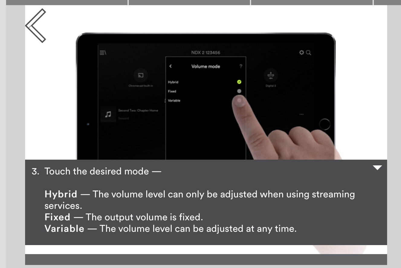

That screenshot looks pretty clear to me. In hybrid mode the digital volume works just with streaming services. Streaming services are Spotify, Tidal and Qobuz. In variable mode it works with anything going through the streamer, so local files, your nas, internet radio, the TV etc.
The screenshot of the help page looks clear, but as I wrote above, it is not true, at least not on Android. I usually use system automation and turned this off to try what Hybrid does. And when I enable it, I have no volume control in the app when streaming. Looks the same as with Fixed. (Both in beta and release app).

Edit: And maybe less than clear after all, because I don’t understand what “digital volume control with streaming services” means. As opposed to what? A digital volume control in the NDX2 when listening to records? I don’t get it
I explained my interpretation above.
Sorry I overlooked that. But for anyone without the benefit of your explanation it is most likely not very clear just by just looking in the app (which explains nothing at all) or little info on the website.
On top of that it’s not even working according to your interpretaion, of course. At least on Android.
Even with the benefit of your explanation, I still don’t get what the Hybrid mode is good for. What is the benefit of only having digital volume for streaming but not for internet radio in the app?
