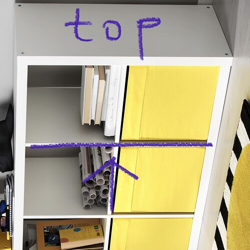

Just in case no one has replied and warned you… rotate by 90 degrees. You are using the uprights as shelves; the shelf is the longest piece.
Same with yours; the square ones are on their sides.
Here the shelf is supported by the uprights in the middle, as well as the dowels left and right.

If you don’t change to correct orientation it will eventually lose structural integrity and collapse. See pictures upthread.

It’s still stronger with the long pieces horizontal; simple physics, supported in 3 places. Those little dowels can fail if that’s all that’s supporting a section full of vinyl, or more likely, the shelf itself would split where the dowels are inserted. The square pieces are uprights.

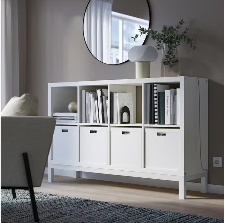

And here’s is Ikea’s own product page showing a 2x4 used in horizontal orientation, exactly as I use them for my record shelves. Either way is fine with this unit, even full of LPs.
Ikea even shows a mis-oriented 3x4 with the footed base on their product pages, but I would not use it that way to store records.

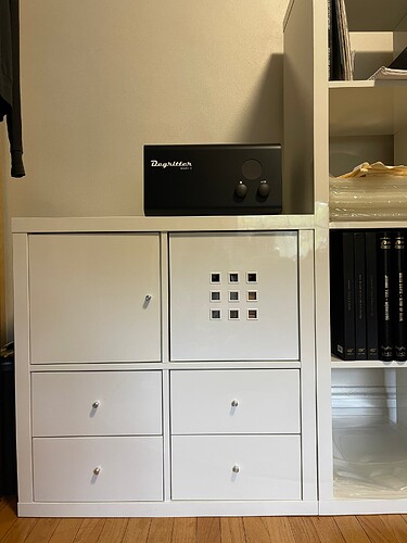

Although, when we use these shelves for records we are exceeding the 29 lb. max load per shelf. Nevertheless, after some 13 years using Kallax – and the predecessor Expidit – these have performed brilliantly for me. I now have three 4x4, three 2x4 and two 2x2 Kallazx in gloss white, all loaded with records, except one that is used for accessories, manuals and my Degritter.
