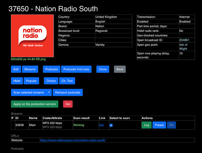

I’ve noticed that the presets remain saved and need to be updated, mostly. The exception is for some stations that I added manually in VTuner using URL’s. These remain working which is a blessing as they don’t appear in the new list of stations, e.g. Nation Radio South. Other stations such as BBC Radio 2 need to be reapplied, replacing the old presets that no longer work.
Hats off to Naim for under promising and over delivering on this one.
I’ve been told by Naim that there may be an issue with some ant-virus software not liking the download. They will ask for a Zip file to be made available tomorrow, which should avoid this problem.
The full Nation radio network is in the new system, plus are at 320kbit.
Easiest way to find tyem is browse Brands->Nation Radio

Thanks, I missed the regional section, found now!
