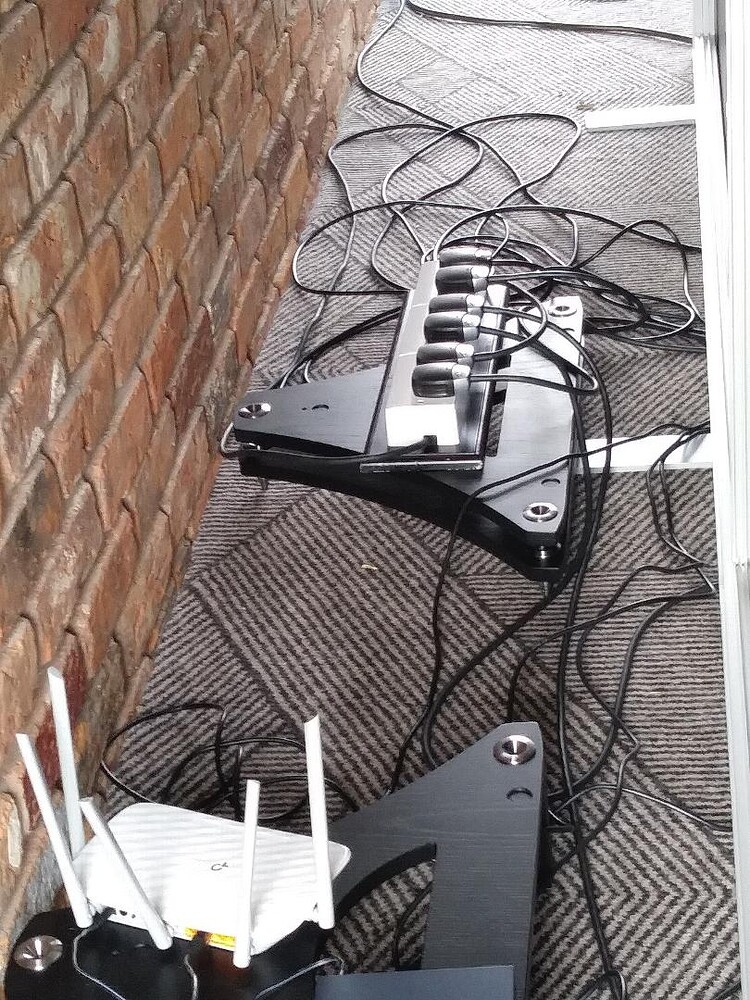

Naim use MK double sockets for shows so must be good enough. :+1:t2:
Isn’t this just one of a gazzilion shows picture that has been around since ~1995 which could be a distributor/retailer as well? I’m not so sure this is how it looks when Naim do shows in general :wink:
They are very poor. Out of the last batch I bought, half of them were unusable due to manufacturing defects.

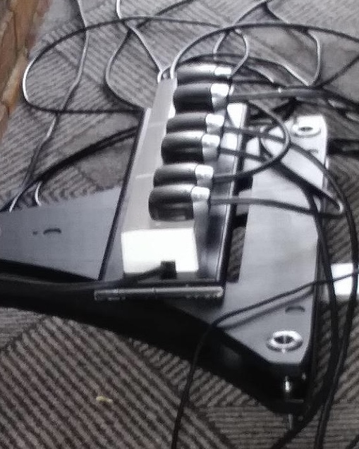

It was a Naim show and the biggest clue is it’s sitting on a plethora of Powerlines on Naim Fraim bases.
Unless other companies have lots of these lying about.
Here is the un cropped pic

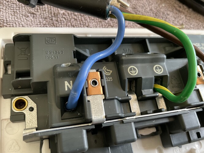

I see where ChrisSU is coming from, a number of years ago I replaced all the crappy 13A sockets around the house with MK Logic Plus. These were all UK made, some with the original copper palletress box earth links, some with the galvanized steel link bars. They have been 100% faultless. However I replaced some bedroom single outlets with doubles & these were Malasian made & although no faults, they left me less impressed.
The next MK Logic Plus iteration is the ā€œRapid Fixā€ that utilises screwless cage clamp connections.
Those are crap indeed and I don’t like the idea. :scream:
I use this type with proper terminals.
MKK0781 13 Amp 2 Gang Double Unswitched Socket - White
Looks like they’re using Wago’s (or a similar alternative) set into sockets now, I didn’t know that was happening….makes sense though.
Any Sparkie in the UK on a new build, renovation or alterations will be using Wago connectors where joints are required…I think all JB’s now are Wago based internally……
I was initially a bit unsure of Wago connectors when they first appeared years back re just how solid a connection they make, but when they have a proper grip, they are sound to the point of not letting go of a stripped end even with a good hard pull….

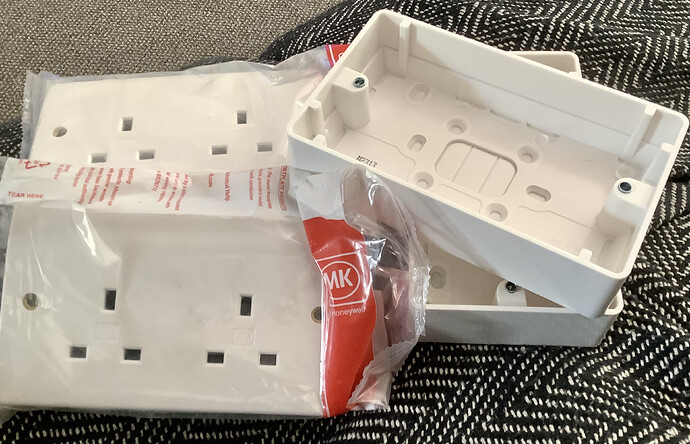

I’ll be sure to add the proper MK part number in future for recommendations.
Thank you for bringing this to our attention. :+1:t2:
The ones that I and I assume Naim use too.

They do have advantages over simple screw type terminals, (one of your favourite peeves I believe) is the screw rotation cuts and distorts copper and can result in connection degradation. Hence why Furutech terms are screwed clamp designs.
The Wago type uses only pressure & actually has a greater contact area along a longer length of stripped cable.
Plus it is BS compliant …
