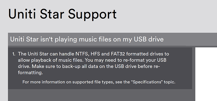

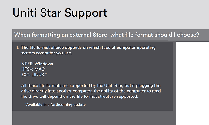

Thanks so much. I wanted to use a 1 TB hard disk via USB, but placing such a device behind or in front of the Uniti Star visualy it was a âno goâ for my wifeđ. I use Mac so AOMEI is not an option.
I donât know if there is software to format a larger than 32 GB card on the Mac to FAT32 (googling didnât turn up any for me), but according to the online docs you are not limited to FAT32 but can use Macâs native HFS as well,
Iâm not sure if this actually is HFS or the newer HFS+ though. On another page about a store for ripping they write HFS+
