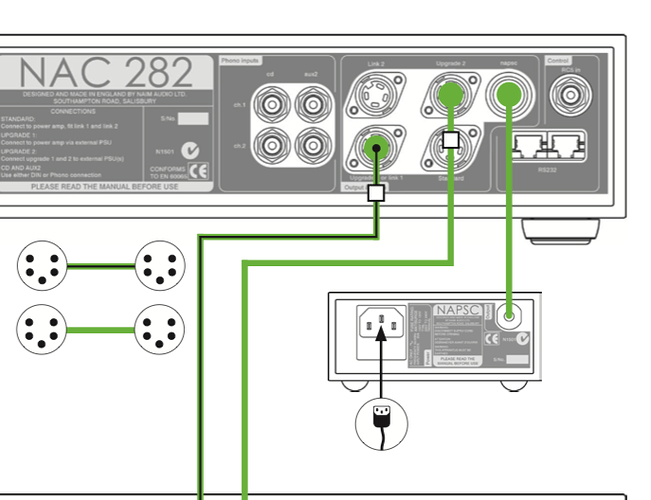

My understanding is that 2nd HiCap or Supercap enable different parts of the NAC 282 to be powered independently. Two Hi Caps may introduce earth ground loop issues I gather as separate devices.
Appreciate many find no improvement with 2 HiCaps or worse, but can someone kindly explain which bits of circuitry each SNAIC connection powers, or does one power left channel, the other the right?

Apologies. I’ve deleted my previous post as it looks like I was wrong. After a bit of searching it appears that they do split left and right - this could be why they need to be perfectly matched.:blush:

According to WitchHat Audio (started by ex Naim engineer), it was posted on PFM that this is not the case & something Naim haven’t bothered to clear up on the forums. The upgrades do not power L & R independently, they power different power stages IIRC. Numerous people have powered their 282 with non matched power supplies, some even from different generations (ie DR & non DR to even Olive).

The 82 is split left and right for the Gain and Time Alignment stages. Mark at Witch Hat apologised for his mistake.

This was in January this year. Another post also provided pics and an explanation of the wiring layout clearly showing split channels.
I can only assume the 282 layout is the same (with the exception of the Buffer stage) as Mark said so as below.
“I owe everyone an apology as I said earlier in this thread that the 82 wasn’t wired L and R between the two power supplies, well on looking in my notes and not relying on my memory I can clear things up a little. The truth is that it is and it isn’t. Let me explain: With one or two hicaps the gain stage is split L+R between the power supplies with one rail from each hicap powering the gain stage and other rail doing everything else - which is most of the rest of the circuitry for that channel. Except the tape buffers are swapped on the 82, but not the 282. This is due to the board layout and mute circuit location and means that the mute will not lift unless both supplies or a link plug are fitted. That’ll teach me not to write about them without my notes in front of me.”

Yes. Signal for L&R flow from just one SNAIC but power to the 282’s L&R rails is fed by the two SNAICs separately.
