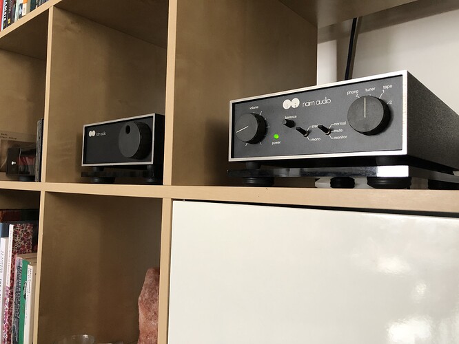

Lovely ![]()

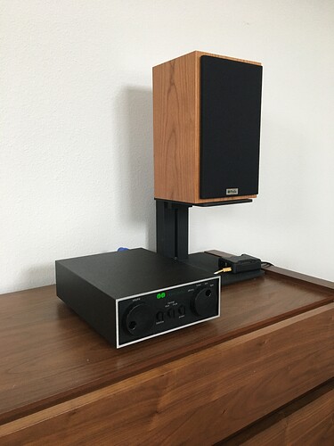

Even from today point of view, this two will work and be successful … soooo good

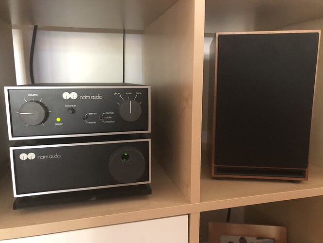

NAC 32.5 just back from Sheffield (Class A) where Darran has done an excellent job as usual. As well as a full service he changed the BNCs for RCAs and fitted a green led to match the NAP 140. Just warming up but sounds great already.
Love that!

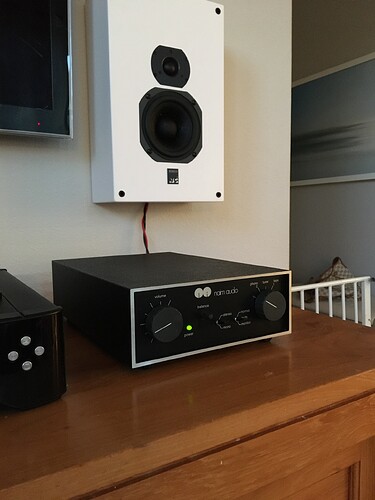

I moved the office system to the bedroom. The Nait 2, Mojo, Tab 10 Signatures are a tremendous combination. Now that the system has more space it is sounding even better.
