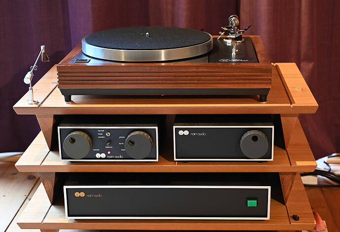

Maybe someone on the forum can answer this question. Some CB NAP250’s, like mine have an orange logo and some white like my 42/Hi-Cap. It doesn’t look like nicotine stain but deliberate. Anyone know why?
Light causes it to yellow. It should be white really.
On some CB fascias from certain years (1985-1986 seems to be most prevalent) the silvery white logo and type tends to go a golden colour with light and time. Some will have been changed for later fascias which don’t show this issue. Not just because of the colour change to the fascia but also because these particular fascias got quite brittle too and so they are very easy to chip or crack when sliding the sled in or out of the sleeve. My own CB NAP250 from 1985 was very golden brown and had a chipped fascia so when I had it serviced at the factory I was lucky too get a new replacement fascia fitted at the same time.
It doesn’t look unsightly, very even colour. It has also been serviced by Class A in June. So I shall enjoy its uniqueness!
IIRC, the fascias that Naim had were done by Darran - very good too - so he’s probably a good one to ask should you wish to change it. IIRC , it’s usually safest to leave the old fascia in place and just fit the new one on top. It does however require the on/off to be refitted.

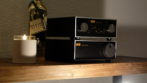

For the record, I’m hereby self-reporting to the Serious Naim-Crime Unit. A while ago I convinced myself that the chrome bumpers were looking a bit outdated – and so I painted them black. Luckily, good sense soon prevailed and the offending black paint was removed before any public outrage could occur. What on earth was I thinking?
