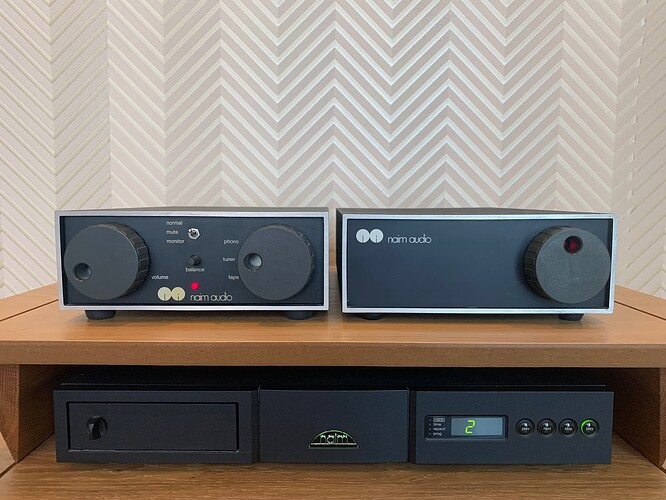

Serviced a couple of years ago for the first time in their history, and I have them since the late 1980’s, and there is just one tiny nick in the case that I have no idea how it happened, otherwise unmarked condition (see a few entries earlier).
Used every day…
Here is the front, a little dusty…

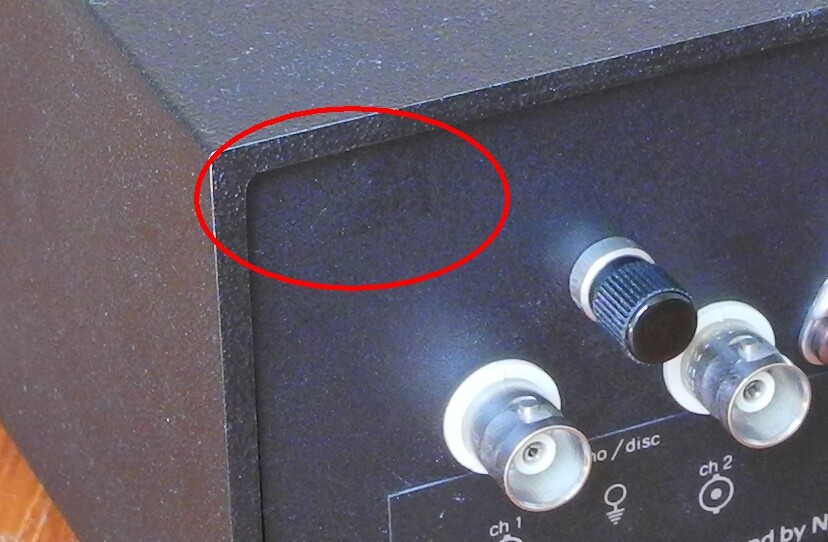

You can just see where the sticker was, I thought I had kept it somewhere, you know, the way we would for the history…

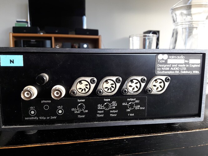

Regarding the Phono boards and BNC inputs. I am looking for some through boards. Naim do not stock these anymore and it was suggested to get someone to make up flying cartridge leads to make the connections that are provided by the simple through boards.
Would be nice to have the possibility to use the BNC inputs with an external Phonostage or any other source for that matter.
Obviously I would like to keep it such that the operation can be reversed so that I can plug back the N boards which can still be used I assume with most MM cartridges
Any suggestions or advice would be appreciated

My experience was that cartridge leads weren’t quite the right size, they can be forced on, or pre-distorted to fit.
I used AMP connectors, type 102103-2 which I think is from the same family as the original Naim pins and board mounted connectors.
Unfortunately I couldn’t find a UK stockist so had to order them from the US, although that was a few years ago. However… this was (probably) an excessive response to the problem and I should have just pre-distorted some cartridge leads!
