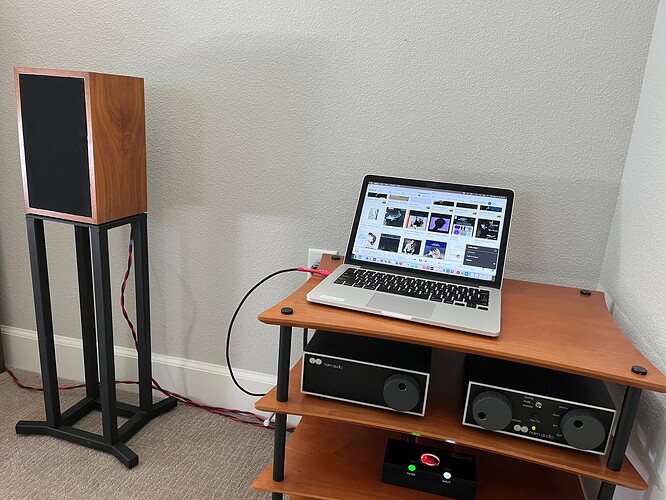

Just took delivery of these fine Mk2 Kans yesterday. It’s the first time I’ve ever heard them. I get it now.
Nice veneer, is that walnut?
You will probably find you can get more out of them in time, with careful positioning, although you will likely need Kan II stands for that. About 150cm between tweeters is a good starting point, so fairly close together.
Thanks. Yes I believe they’re walnut. I didn’t know that about the 150 cm recommendation. I’ll try it.
