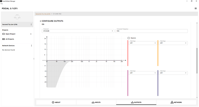

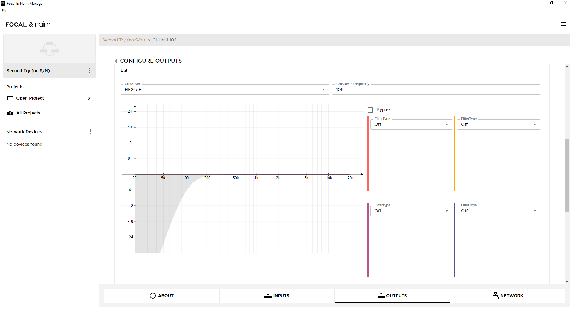

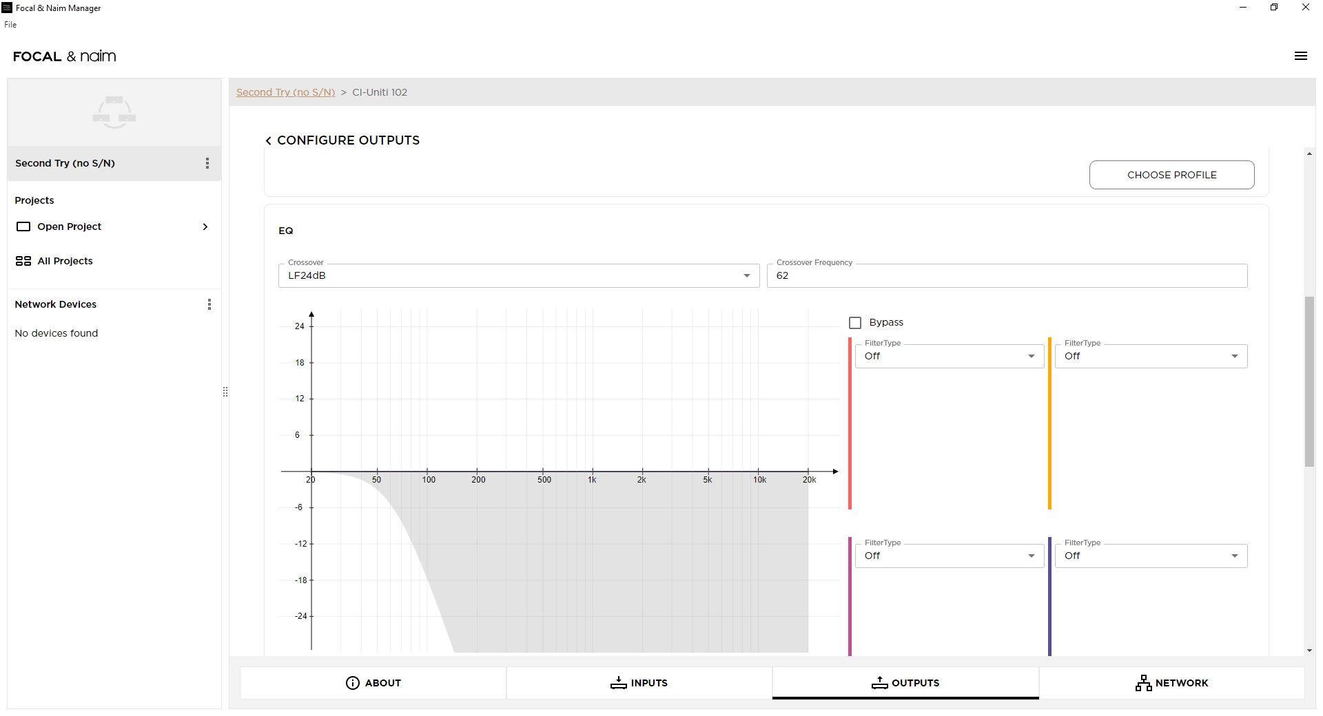

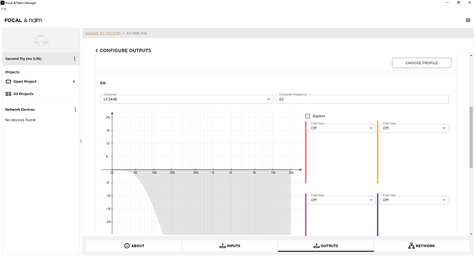

Nevertheless, I think it may help others see some visuals - so I hope you don’t mind my sharing screenshot images of the Focal/Naim manager view for setting the main loudspeakers and sub bass outputs as you have described?
By choosing the crossover (between main loudspeakers and sub bass) at 80Hz with 24dB per octave slopes I have assumed that the output for the Main Loudspeakers have been set with a High Pass filter ‘HP24’ and correspondingly for the Sub Bass a Low Pass filter ‘LP24’.

Are my assumptions shown above in screenshots correct for the quick experiment you tried?
Note that I needed to use a corner frequency specification of 106Hz for the High Pass (for the main loudspeakers) and 62Hz for the Low Pass (for the Sub Bass) to achieve the notional -12dB at 80Hz for both the LP that you described in text and by implication the HP.

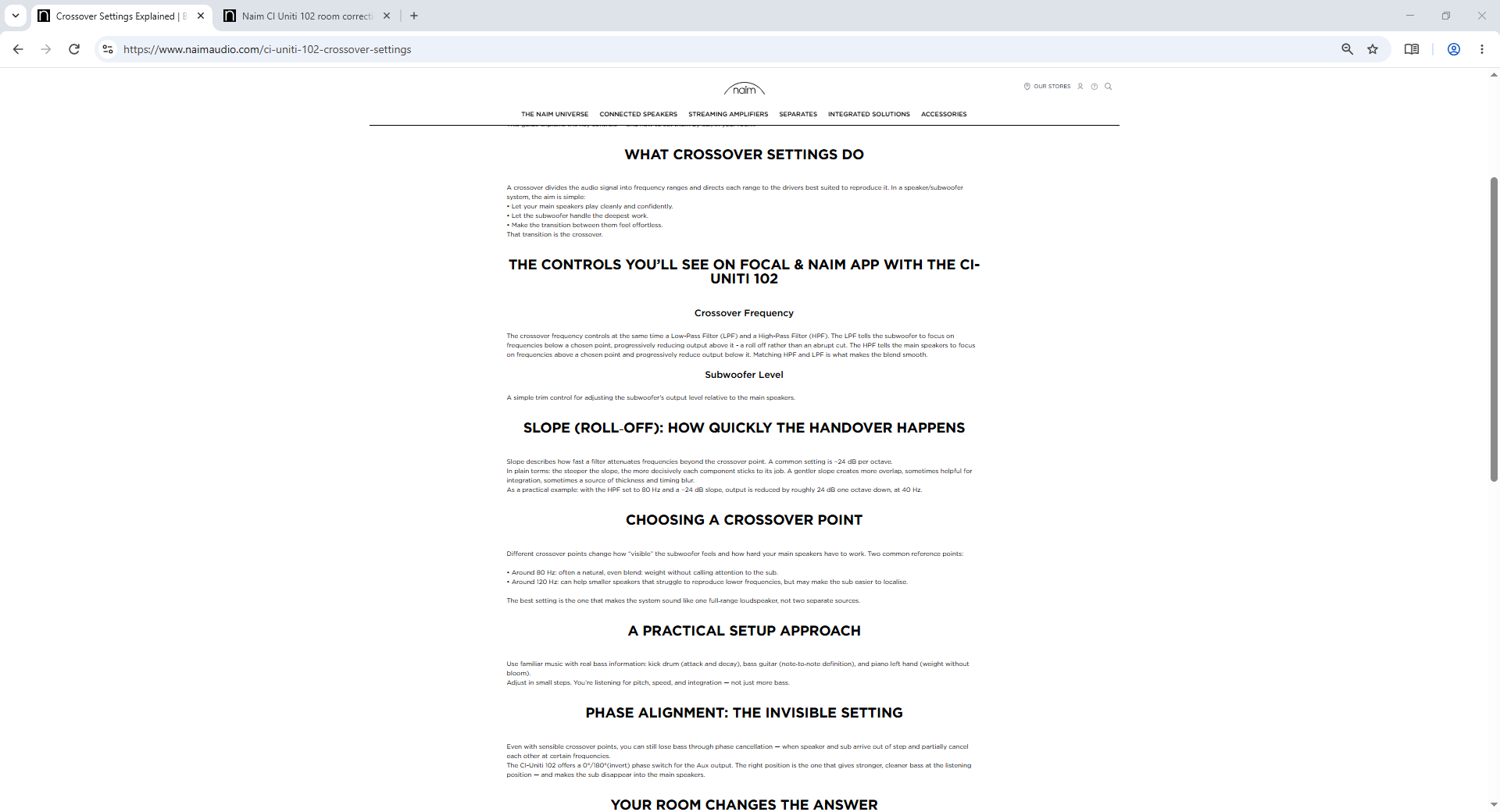

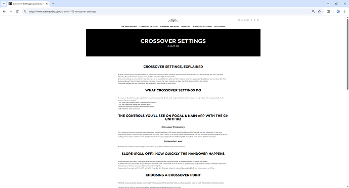

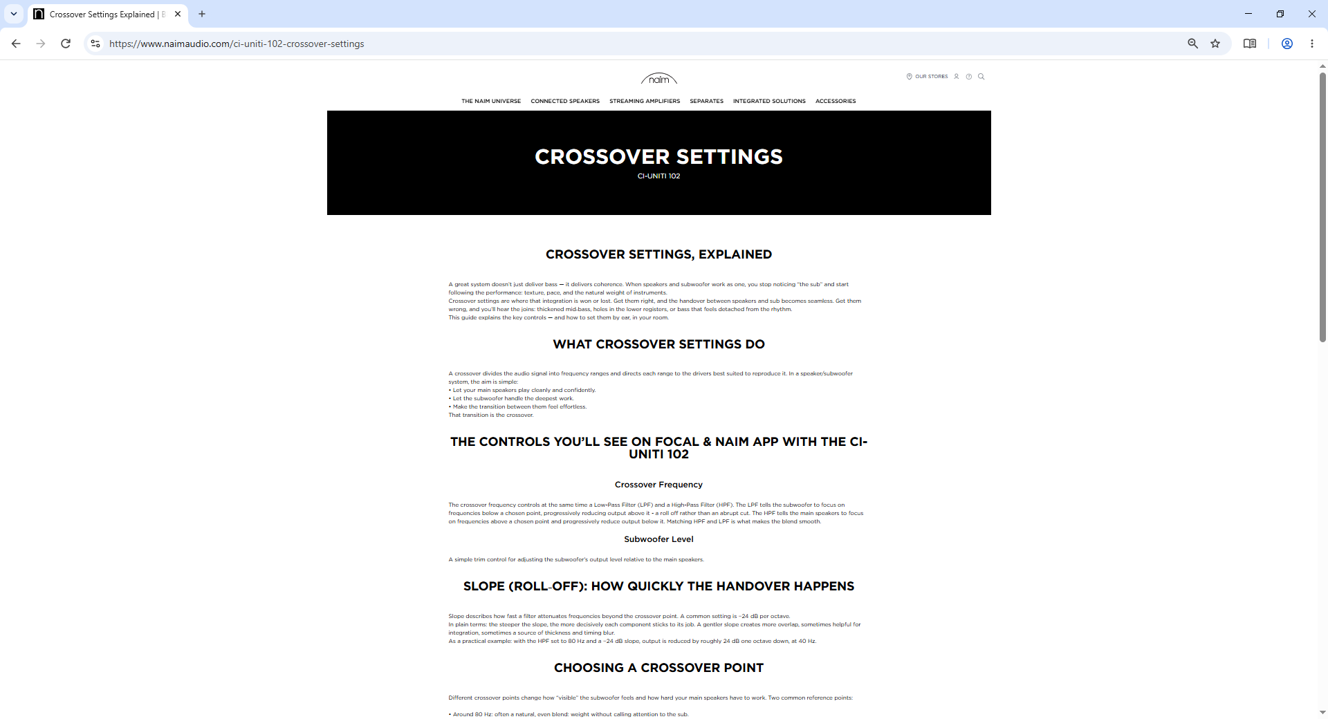

Looks like Focal/Naim are beginning to provide some direction now…
Here are screenshots of the latest website link.
and actual link here…
https://www.naimaudio.com/ci-uniti-102-crossover-settings
