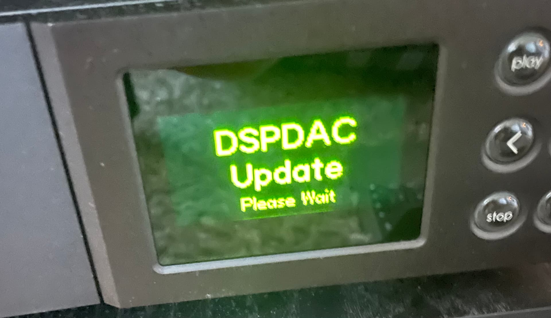

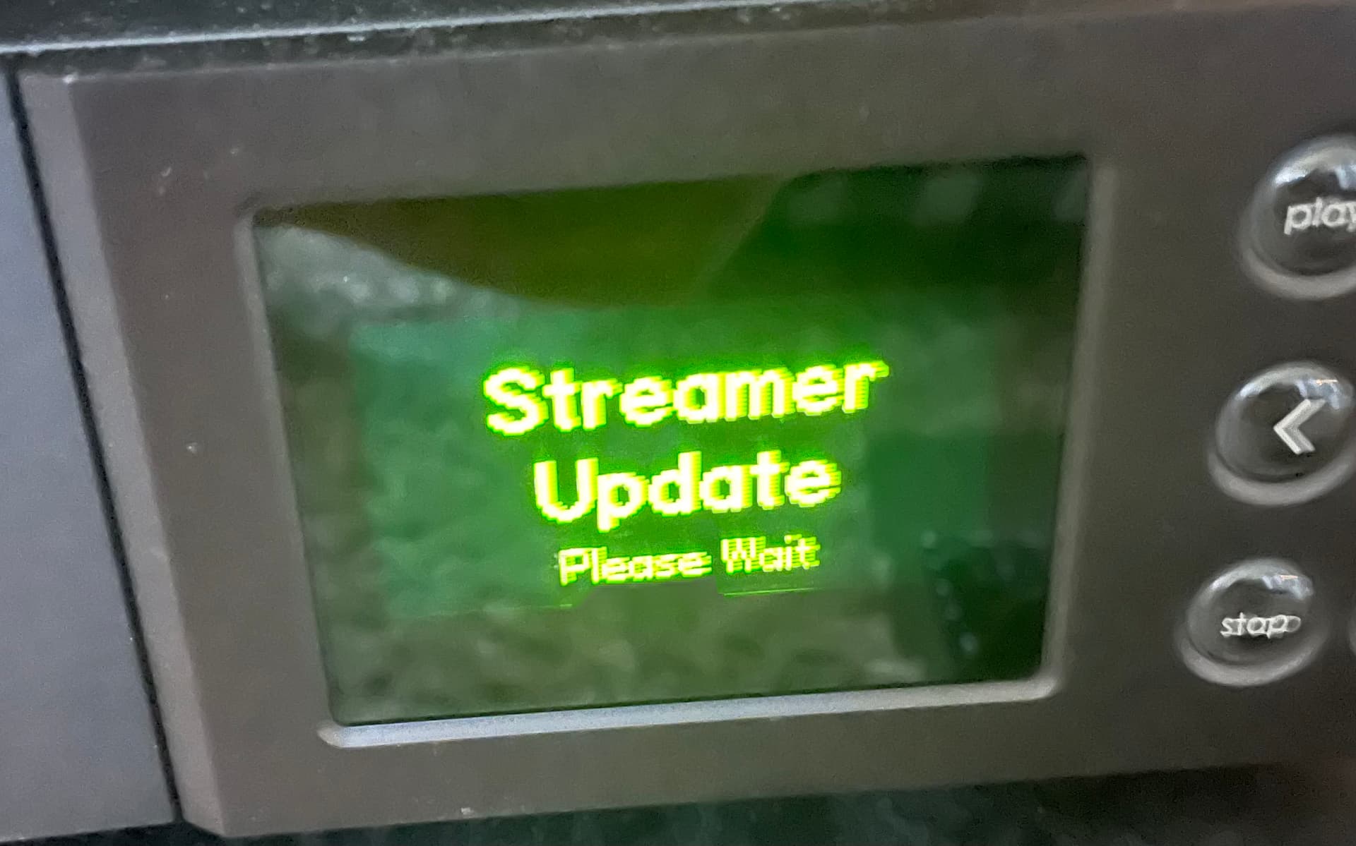

Got it done while cooking dinner. Who said men can’t multitask!
I’ll try and get it and have a go. Will let you know
272 in progress. And done. Works great, sounds great ![]()

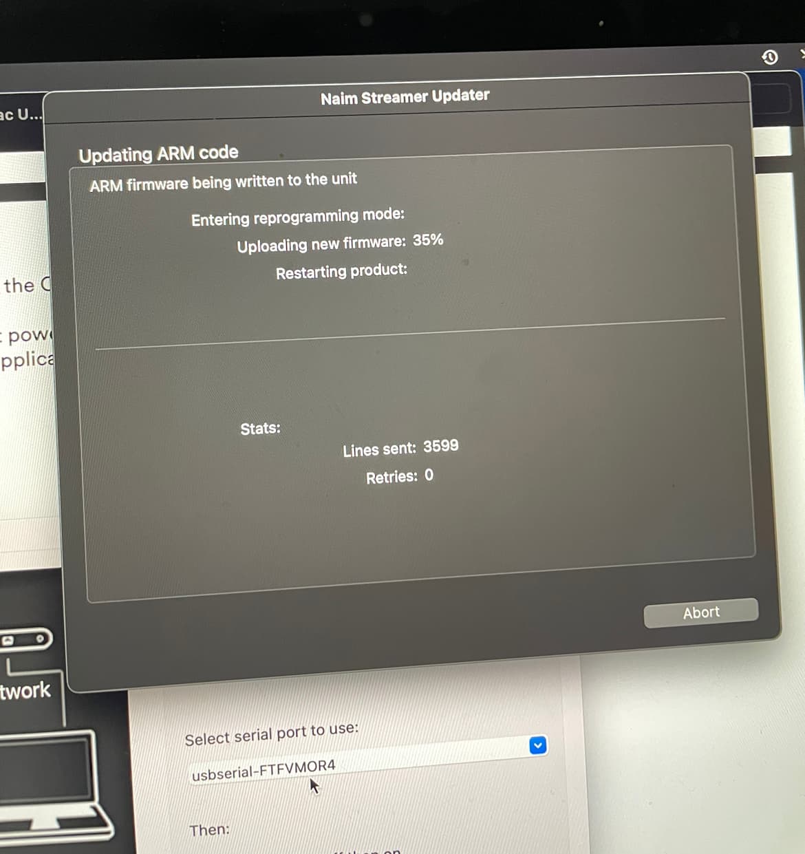

Updated with macbook air M1 wireless and 272 wired. USBC dongle to USBA to USB Mini B. Battery sleep to never. Initiated Naim updater, chose usbserial-001, western Europe and off it went.

You have to go to security & privacy from system preference and open ‘anyway’ the Naim Streamer Updater from there. Non Apple Store apps are blocked by default. Hope this helps.
Yes as said by ChrisSU
However before you do go to 4.8, part of the instructions include to uninstall the old installer; if you do this it will uninstall 4.4 if you haven’t already moved it.
So move 4.4 to a temporary folder before you uninstall the old installer software.
Then when the new installer is in place, move the 4.4 software back to the normal firmware folder
