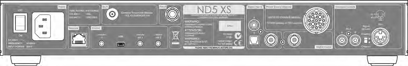

Does ND5XS carry RS232 or mini-USB B ?
Mine’s a late 2015 unit
thank you

This is a well known error that occurs on some of Naim’s printed rear panels of a particular age. In any case the socket shown on the photo is a miniUSB. So if your’s looks like that, that’s the lead you want.

Yes the picture shows RS232 printed, but the actual port shown is a mini-USB so the picture is wrong. My drawing picture is from the manual.
The other thing is (I believe) RS232 was only fitted to NDX & changed soon after, my 2014 NDX is a mini-USB, & if I’m right ND5XS was never produced with RS232.

Also , when update is performed using MacBook Air a fully wired USB C (and not A ) to Mini-USB B cable is the right one, right?
In that case may I use the one that comes with an Asus burner since data is involved?
2 min photoshop job to make it right
Yes but the issue is that the panels were printed incorrectly for some early production and Naim either didn’t notice or decided to use them rather than scrap them.
I still think it may be technically correct because RS232 is a protocol and not a port specification, but it is quite misleading in the modern age where few people can distinguish it. We had this before ![]()
