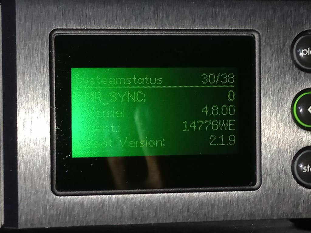

All’s well. I did get another USB cable. The other one did make the laptop go bing/bong and said something about a driver. The other cable seemed to do the trick and the driver software appeared as per the screen shots in the guide. Thank you very much for coming to my aid and the notes from the other thread helped a great deal. The power of this great forum is a big thing when presented with queries and problems. I’m now looking forward to a glass of something calming later on and to see if I can hear an improvement in the sound quality. Tidal is up and running and it’s good to see v4.8 in ‘about’ in Tidal. Thank you.

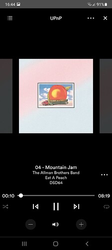

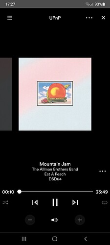

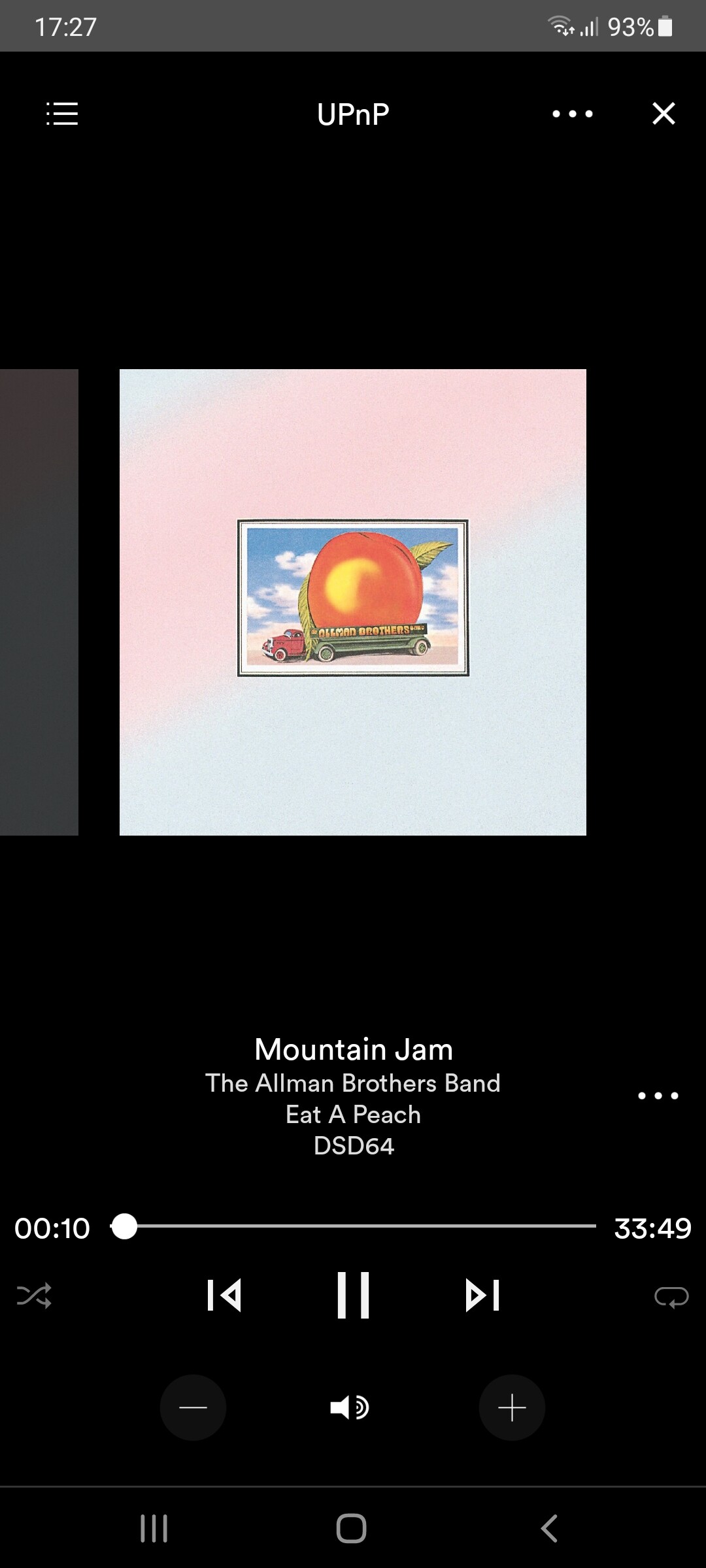

Installed 4.8 without a problem but alas…
Long DSD tracks (only when they are .dsf, .dff files play fine as before) is NOT solved… :frowning_face:
DSF file
DFF file
I know @Stevesky is looking into specific DSD files people are still having issues with, so flagging this for his attention.

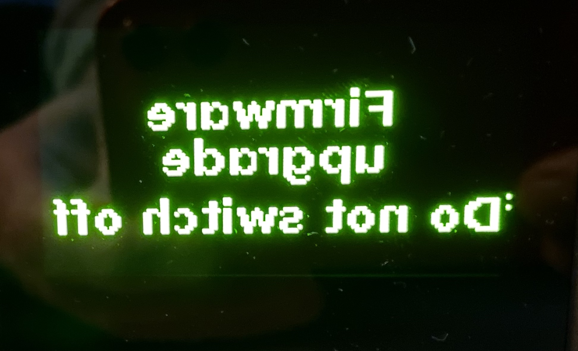

Is it installing the update in a mirrored image kind of way?:sweat_smile:
This looks more like it
is that for real? Or photoshop?
Pretty serious (although funny because it isn’t mine)…
It is for real
Should I worry?
no, you shouldn’t worry - several people have noted that happening during install. It’s like it’s checking to see if you’re paying attention!

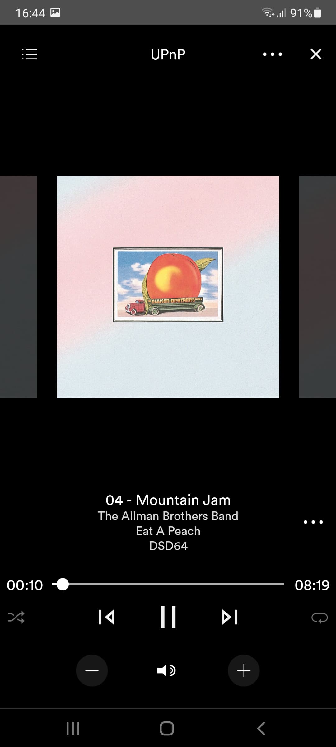

Added some pics for extra info if needed.
I sent two of my four problematic tracks to @Stevesky, who was able to replicate the behaviour (Whew, always nice to confirm with weird problems like this that I am not just crazy and/or impossibly incompetent).
The whole lot has now been shipped off to the third party who handled this bit of the software development for further analysis.
I notice from your two pics that the same general observation that I have made applies. The difference between what the Naim app displays/plays and the actual time is about 25:30 (in my tracks it’s 25:22)
