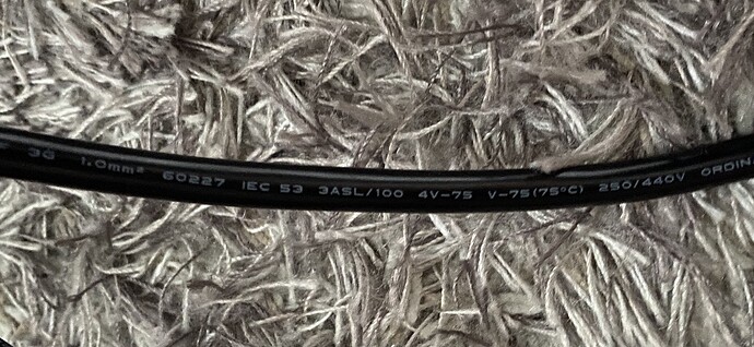

I’ve been evaluating different mains cables for my 272/250DR and cannot say I hear any difference between a say 2.5mm2 core cable and the original 1mm2 cable. However I noticed that the UK cable seem to be 0.75mm2 compared to the standard EU mains cable which is 1mm2. Is it a change recently to 0.75mm2 or is this for UK only? My SN3 also have a 1mm2 cable so I assume different for UK and EU then. Strange.

I have two Naim originals and it is printed 1mm2 on both. (Sweden/EU plug) The UK one I believe is 0.75mm2 though. Therefore my question why there is a difference. I-Sheng cable.
I suspect at the time when the 1mm were shipped, that was how they got shipped with the EU (Schuko) plug. It’s no big deal, 0.75mm is 6amp, 1mm is 10amp, both significantly more current than most Naim amps draw in normal running.

If that would be 100% true then why does the Powerline have 4mm2? I’m not questing you. I’m just interested in understanding why Naim is not consistent if they seem to believe thicker cables do change performance. There’s no Naim amp requiring more than 10A I assume. Thats 2400W…
Because they supply 4mm as standard with the top of the range units, in many cases it’s way way over the actual current requirements, but it’s what they do.

For the standard cables, Naim source a bunch of inexpensive off-the shelf alternatives and go with whichever one sounds best. Sometimes supply dries up so they have to find another one, and it’s the same selection process. The Euro Schuko cable is/was chosen on exactly that basis - the fully moulded IEC-Schuko lead that sounds best to Naim. The UK can’t use the Schuko cables as they come with moulded plugs and the UK requires a different plug. Here again, Naim select the standard unterminated IEC cable they like the sound of best when fitted with their choice of UK plug, which was the Crabtree, then, when supply dried up, the MK, now their own Powerline plug, making the Powerline Lite).
