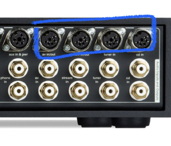

Use any of these 4 din inputs; cd, tuner, stream, av.
Aux is best avoided as it is a powered socket designed to connect the Naim stageline and superline phono stages.
And just in case you don’t know - yes the din sockets (and the power supply socket) are supposed to be wobbly. For source components, don’t connect the din locking collar, leave it loose.

Do the DIN sockets on the SN wobble? They do on my XS3, but that’s because the sockets are PCB mounted. I thought the SN sockets were wired internally, not PCB mounted, and hence firmly mounted to the casework, you can see the fixings in the photo?

You are quite right, they don’t wobble, and are firmly fixed to the chassis. Decoupling is achieved by means of the little wires that connect them to the board. It’s only the ‘5 series’ that has wobbly DIN sockets. The mains socket does, of course, wobble.

Which wouldn’t fit in the Aux in & pwr socket. This is a DIN5 240 degree socket, designed to take a SNAIC5. worth reading Richard’s post second down on the thread if you’ve not done so already.

Going crazy, yes you are right - you can even see the fixing screws in the image. Lots of internal wires provide the necessary decoupling; it’s a pig to do apparently.

I’ve been looking at photos of the back panel of the SN3 to understand the inputs - and this brought up two more questions.
Why to the DIN connections for AV and Stream have IN/OUT written on them - while the AV and Stream RCAs are just labeled as IN. Does this limit those inputs for other Naim equipment only? It looks like Tuner and CD DIN connections are labeled as “IN” only.
Does this mean I should connect my phonostage and my DAC to the Tuner and CD DIN inputs only???
The DIN inputs which also have outputs were originally for tape players, which could record as well as play so needed connections for both functions. The Stream in/out socket might similarly be used for a digital recorder.
It’s fine to use these inputs for any purpose. An input only lead will still carry the signal and work normally, and the output pins will be connected to nothing.
