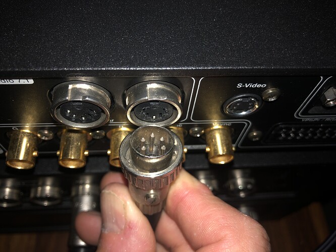

Hi all, i’m Being very patient and have not switched anything on yet. I have had to buy an extra naim snaic din lead. So I hope to fire up a cd this week. I bought an aftermarket din to rca for my turntable. Standby.
Just to confuse matters I have a naim dvd unit for cd playing. which I did not realise the dvd had a built in amp and 5.1 surround but am hoping that will still give a simple stereo output.

A SNAIC 5 is for connecting pre-amps to a PSU e.g. A Hicap to a NAC 112
What you should have bought is an interconnect cable. This has a different pin arrangement to a SNAIC.
