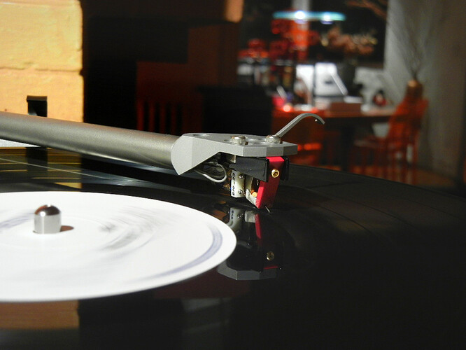

That’s a good shot, kuma, of your Etna.

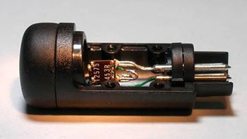

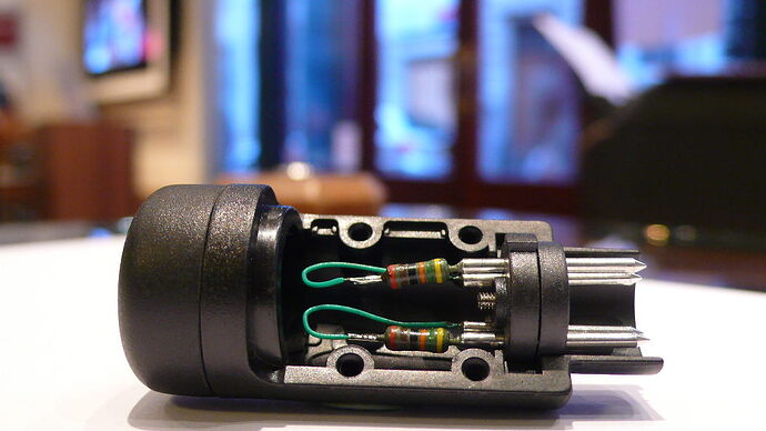

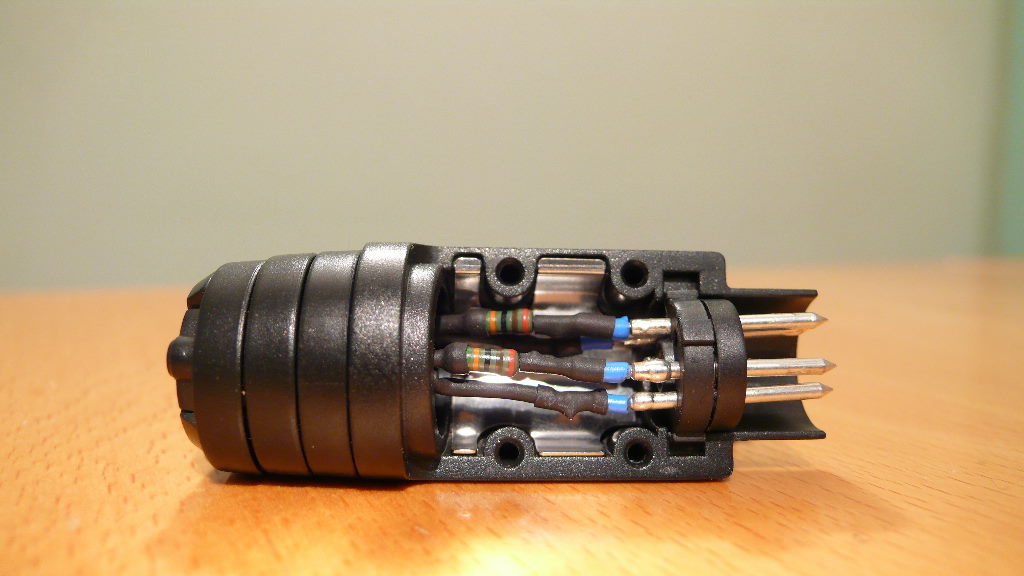

Richard, I would love to see inside your Airplug. Here are a few innards of 2 different inside Airplugs.
Standard Airplug:
Z-Foil TX 2575 Airplug:
A variation on a standard Airplug. IIRC, this was an early one. I can’t remember where this one came from but the execution is a lot to be desired.
