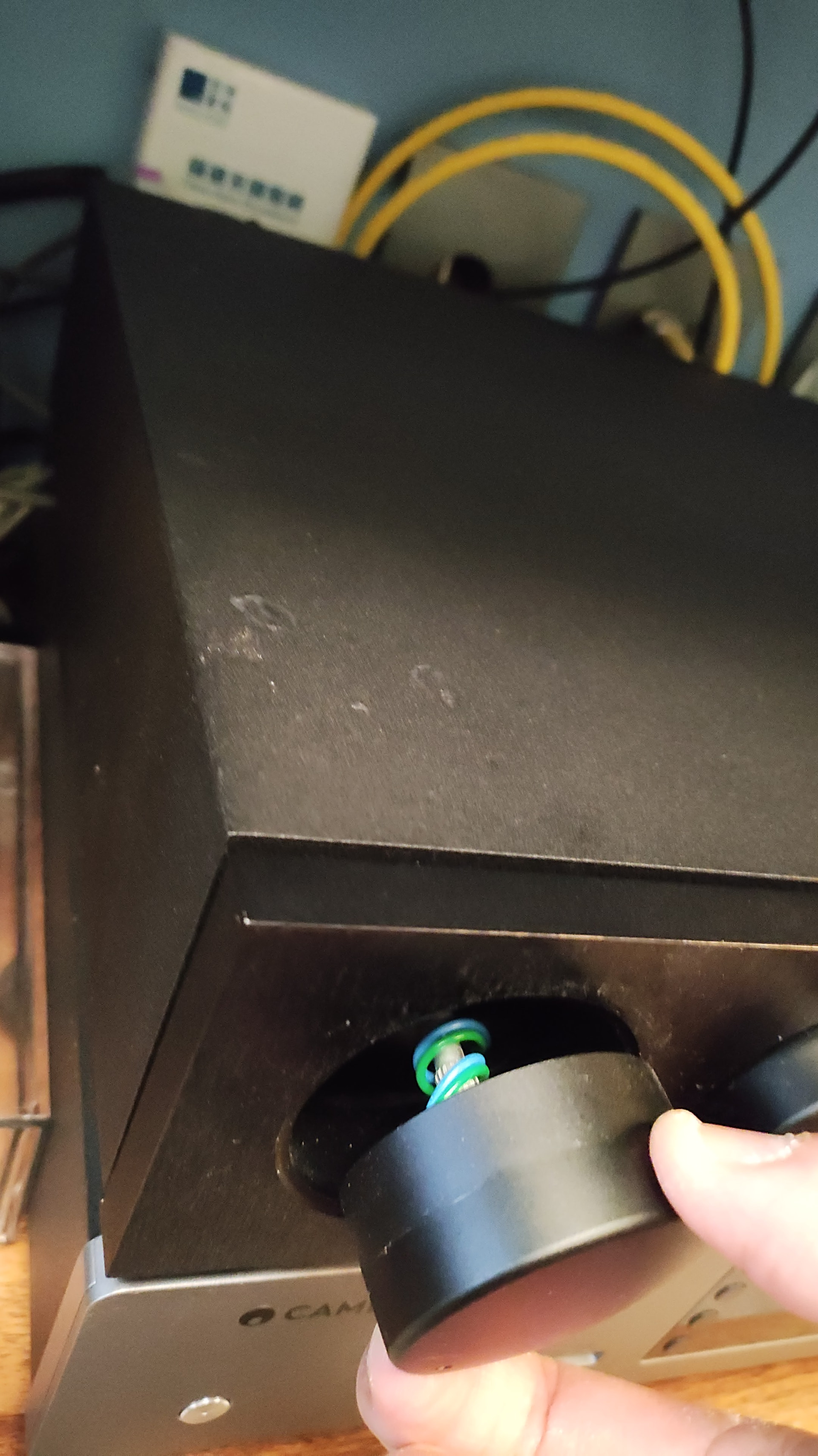

Turn the volume knob anti-clockwise to take up much of the slack of the LED cable with the potentiometer in zero position. Plant volume knob back on the shaft at around the 7 ‘O clock position. Job done. Listen to some music.

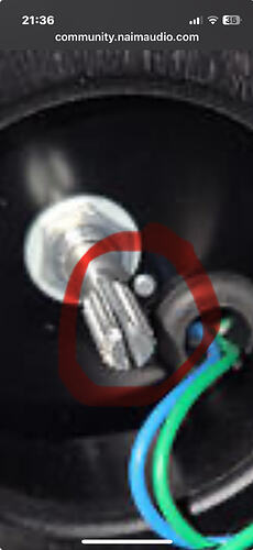

Think he means put it in this slot,
Spot on!
Regards
Neil.

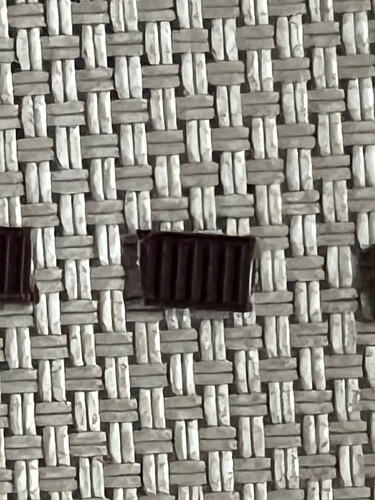

If use cable tie, the tread is covered and the volume knob can’t fit

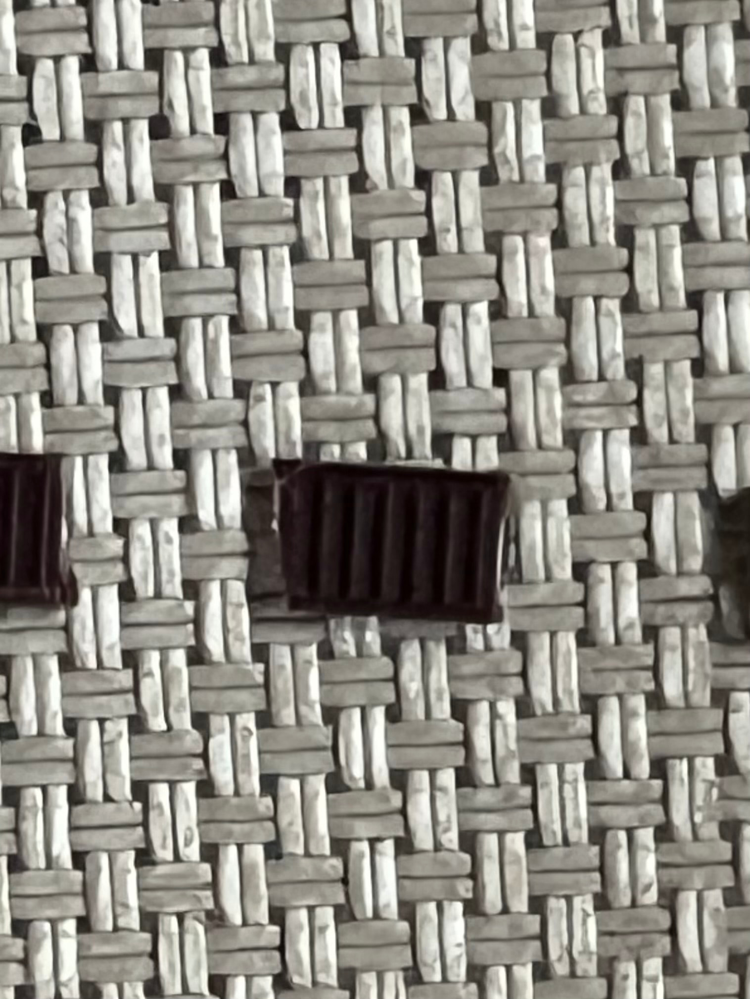

Cut a little bit of cable tie off,
Slid it into slot

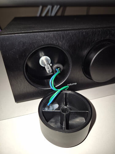

Put knob back on
