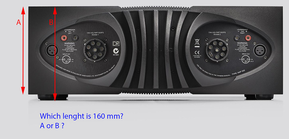

Hello,
I’m looking for information regarding size and weight of the NAP500.
The info provided here:
Is the following:
Height : 160 mm
Weight : 25 Kg
What weights 25 Kg?
NAP500 only or NAP500 + 500PS ?
And regarding the height, what exactly measures 160mm? A or B?
See picture below
Thank your for your help
Thomas
Thomas - mine is 160mm inc the solid feet. Do remember the venting is done via the top and I think you should allow a good 50mm ++ for this, noting it has a fan too although mine rarely, if ever, has come on.

And regarding the weight? Have you an idea?
Thomas
Looks like it’s time for a move to brain and brawn stacks for you, Thomas!
500 Head = 25kg per the brochure specs* and the PS = 15.4kg (I think heavier than a 300PS?).
Shipped weights heavier - the 500 has a big box!
*a pre-DR statement but I don’t think DRing adds much if anything(?)

A last question : do you use a “Fraim” ? If so, how much space (in mm) do you have above the NAP?
Yes I have Fraim and double height (Tall as listed) uprights to accommodate the 500. I think the gap is ~95mm from the top of the 500 to the above shelf. This is (obviously) due to the design of the Fraim not a specific need for the 500. I’m not sure if a 500 can be used with a Medium Height Fraim shelf - recognising you are using the glass shelves at the moment? The measurements on the Naim 'site suggest a 500 can be used with a Medium height upright as the available height for use = 180mm.
The manual only indicates that the top & bottom vents shouldn’t be blocked e.g. by carpeted flooring. You may be OK with only 25mm gap above but the more is the better in my view.

I use my NAP 500 with a medium Fraim which works fine and looks good as there is the same gap at the top as using a standard Fraim with NAP 300.
No need for a tall Fraim in my view and medium Fraim is more stable than tall Fraim so you can build higher.

Put the 552 on the vacant top shelf, remove the shelf it was on and it will fit in your rack where the 300 is now but get help putting it in there, I nearly gave myself a hernia trying to feed the head unit into the gap I’d prepared for it in my Fraim.
HappyListener,
Thank you for your help with the NAP500 measurements and positioning. I’ll have to modify ma rack in order to accommodate the NAP.
