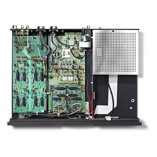

OK, with the cover off, have a look at the area in the picture - if the fascia has been fitted slightly out of line with the chassis & the logo ribbon has exposed conductors at the far end of the connector, the screening fence can short out the IR line to ground. Temperature fluctuations & movement of the fence can produce the intermittent symptoms you describe.
A slither of insulating tape or similar inserted between the fence & the logo connector should fix it.
This is a bit of a long shot, but I have seen one or two examples of this in the past, in the service dept. we now fit a piece of kapton tape to the end of the fence to prevent future problems.

Well its played up once more yesterday after being fine, anyway took the lid off and did the mod above and we will see if it sorts it
