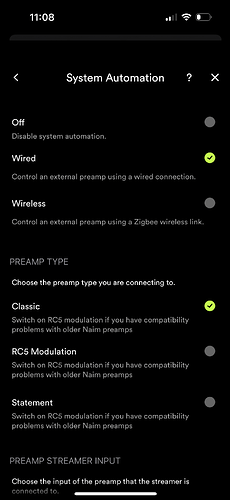

There’s also this config screen in the app, which is I think what you mean… now I’ve enabled it the remote no longer controls the SN2, but clearly there is some functionality there!

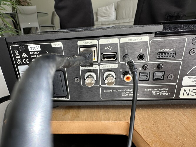

Is it just a simple 3.5mm to 3.5mm cable i need to connect?
Yup. There seem to be 2 ports on the 333, I used no1… SN2 just has one
Then in app enable one of the non fixed volume modes… but leave SA off… that allows SN vol via app or 333 remote. Turning SA on seems to stop it working which feels a bit weird!

The SA config in the app alludes to other control over classic preamps, but nothing happens when I enable it… in fact it stops the volume control working
Clearly this function is supposed to do something, but the manual doesn’t give anything away
Edit: I’ve been messing around and the SA function enables me to change SN inputs via app and volume. For some reason the remote volume stops working when SA enabled though which is annoying!

Have you tried the volume control settings in the app, or SA, or both? Does SA stop the 333 remote volume working on yours? I’ve emailed naim to see if it’s a bug

I gather you have a SN2. You should enable system automation, which lets the 333 remote, or the app, control the SN2’s volume and input switching. It will sound better that way, and it’s how Naim intend you to do things.
Ok, so you’re saying the SA config route to controlling volume works differently from the volume config route. Sounds bizarre - unsure why 2 routes would be needed - but I’ll take your word for it. Perhaps I’m missing the point!
If SA worked with the 333 remote I’d do it!
Had a test out on my NS333 and SN2 with the 3.5mm cable connected to allow system automation.
