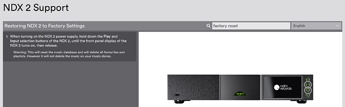

Well; i’ve just done this latest update and what do you know, my NDX 2 is now, for the very first time since i purchased it in June last year, is now doing random reboots. You could not make this stuff up! It’s comical.
Do a factory reset, maybe…
It could be the update process was interrupted - I would also suggest a full reset
Is this just a case of turning everything off and then back on again, if so, that’s what i’ve done.

    1. When turning on the NDX 2 power supply, hold down the Play and Inputselection buttons of the NDX 2, until the front panel display of the NDX 2 turns on, then release.
Warning: This will reset the music database and will delete all favourites and playlists. However it will not delete the music on your music stores.
Ok great. Thank you. I will try this.
Good luck! Very annoying indeed, I hope it goes away!

Thanks here for the tip. I have followed the great advice here. See what happens. Never been a problem before. Hopefully all is well. My NDX 2 or ND5 XS 2 before it has never had a random reboot or screen lock issue. As for the sound quality, it’s exactly the same, which is good. :slightly_smiling_face:
The new firmware update seems generally to be going well, but just in case anyone is having problems with their ND 555, I discovered a while back that there’s a difference between the so called “Factory Reset”, mentioned in the supplied Quick Start Guide, using the front screen and the remote, and the procedure I found on the website.
