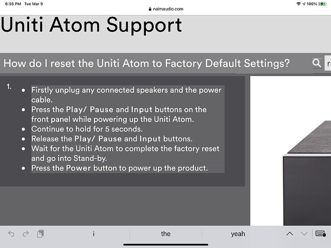

I just downloaded the new update, and now the Atom isn’t responding. I tried disconnecting the power, no luck, tried again, and then the pair remote instruction came up. But the remote won’t pair. And the power is flashing. The screen is still on the pair remote page…
Hmm…ok…I tried again…like the 3rd or 4th time…and it seems to be working now…I will mention, the re-set instructions are ambiguous.
The instructions say “press…while powering up…”
does that mean press them when/ while you plug it in? Or does it mean plug it it, and then, as you press the power button to also press the play/pause and input buttons? I did the former and it failed. Then I did both…
As you discovered, it does mean hold the play/pause and input buttons in and then plug the power lead in again.
