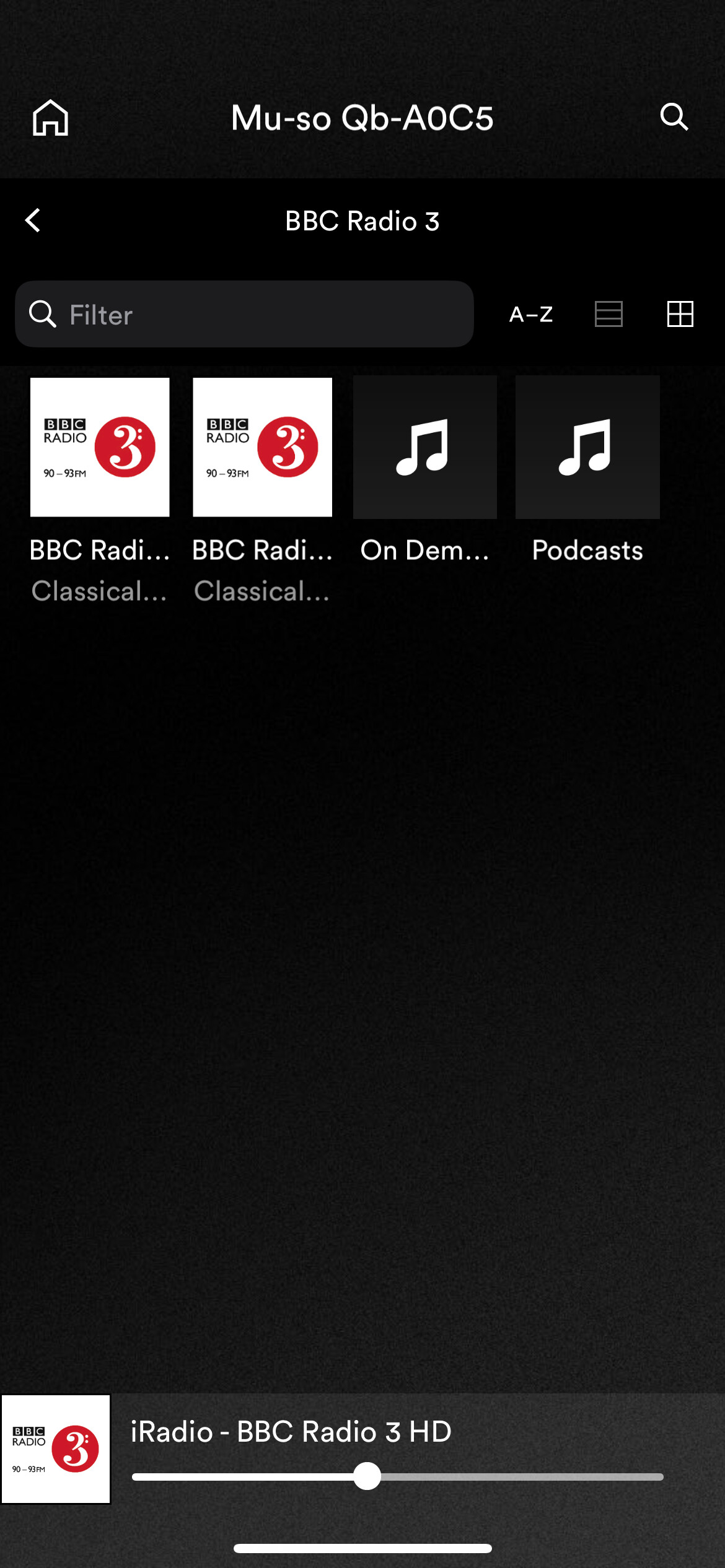

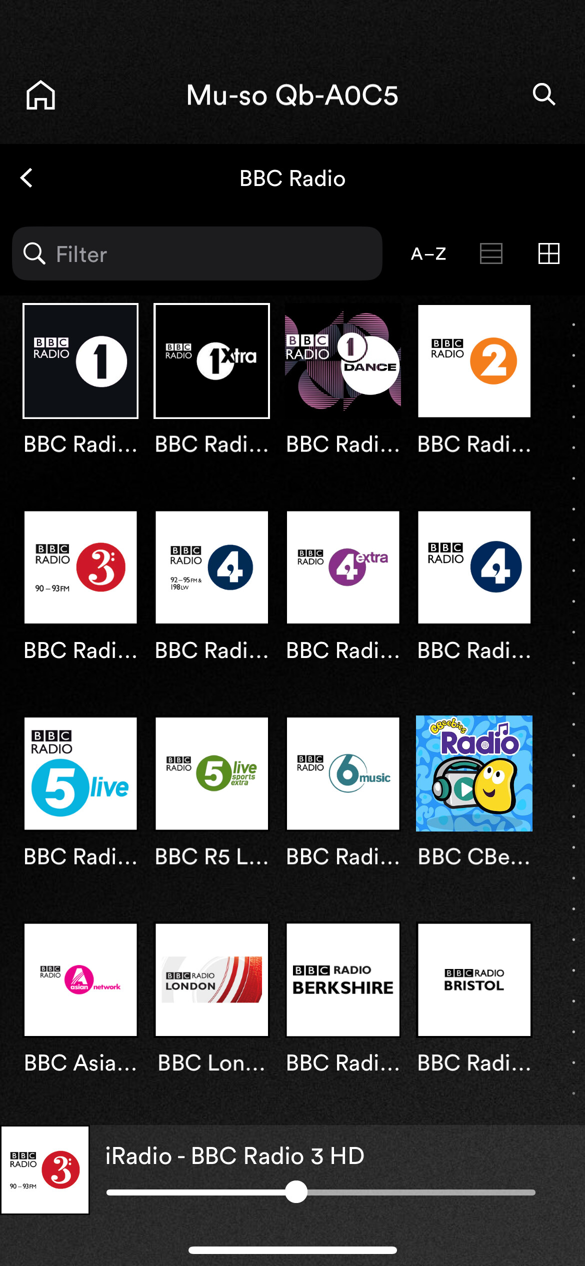

The BBC are on the final stages of moving to the token authenticated streams. For those that have had BBC stations stored in presets for a long time, you might need to browse to the BBC radio section, pick the station (it will hopefully play), then re-save the preset.

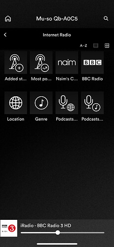

yes itâs v-tuner. Ignore BBC for the present and try any station say from ânaims choiceâ folder or wherever just to see if that works first. If you select âinternet radioâ you should see folders containing various stations etc
