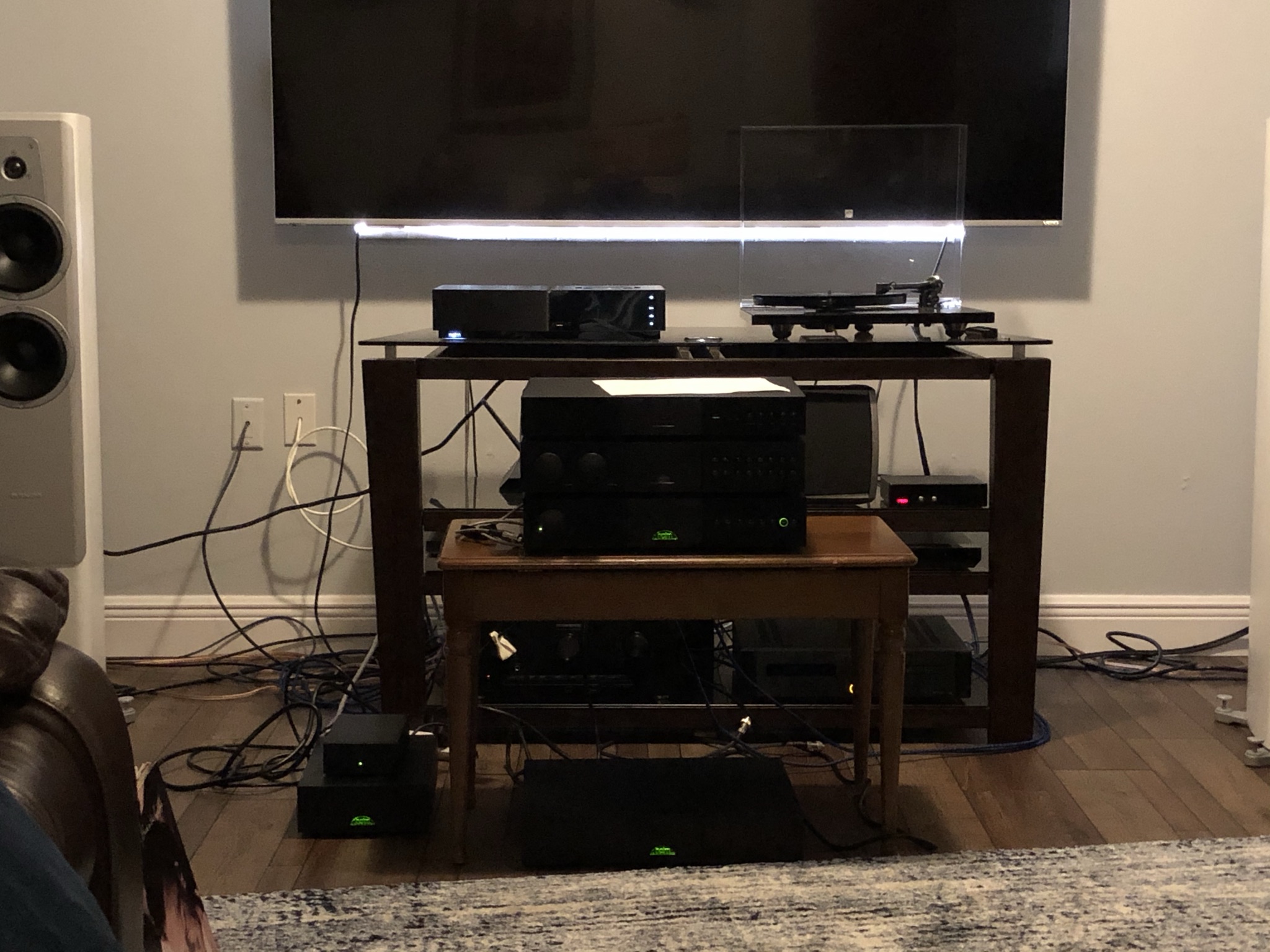

I would definitely verify that the Naim DAC has the most recent firmware. I use the Node 2i with Wire World Mini Aurora power cable and BJC Coax to BNC cable to a bare 272/250.
I first compared it to the built in streamer and the Node was better on Qobuz and internet radio and the 272 was a bit better streaming from the NAS.
For fun, I completely turned off the streaming section of the 272 and unplugged its ethernet cable.
With that set up, the Node2i is more musically engaging than the 272 ever was and I find myself using it way more than I ever used the streaming section in the 272.
The LP12 (my main source) sounds better as well so my guess is turning off the streamer made the preamp/DAC section better.
But who knows? Audio is wacky. My cup of tea may not be yours.
